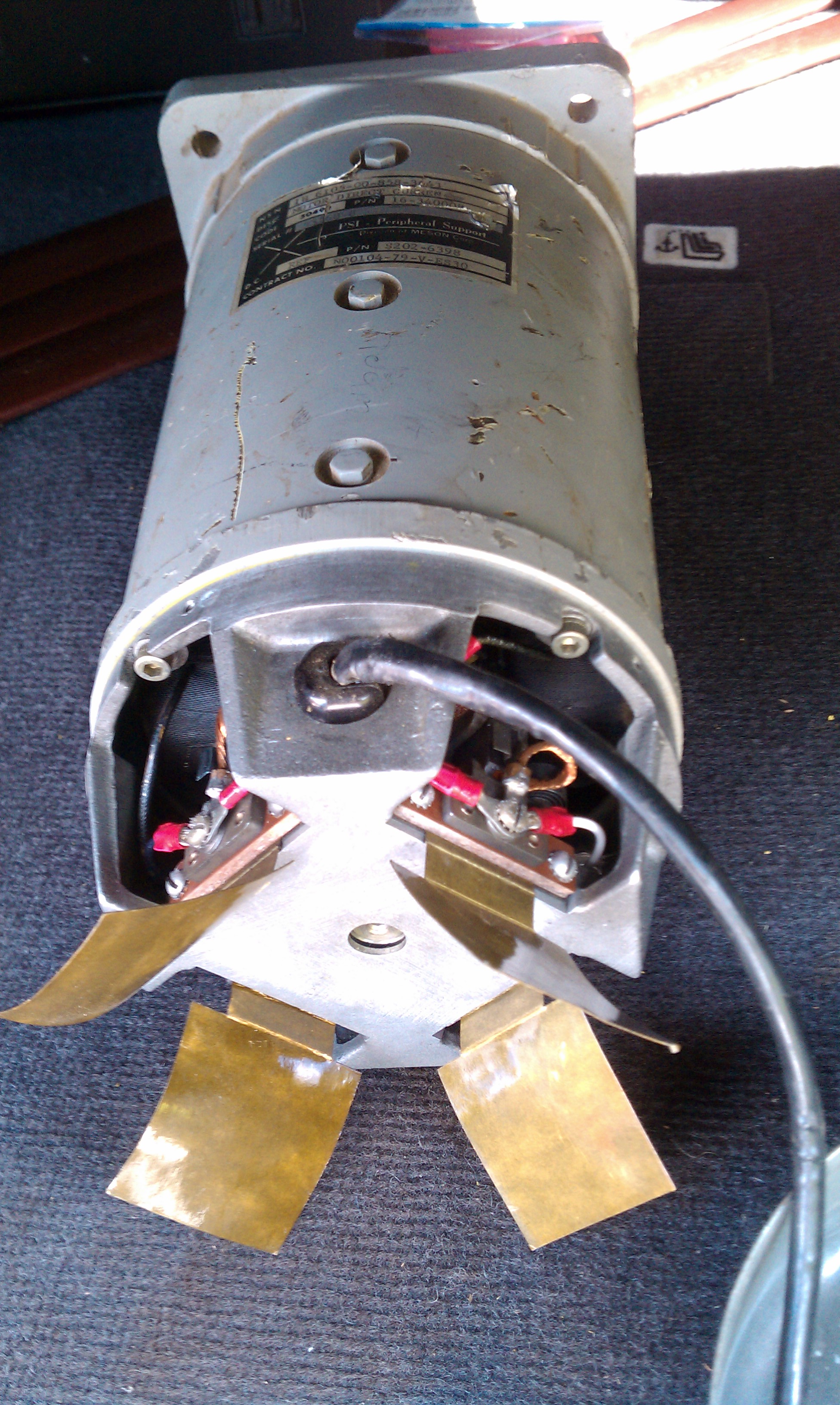

i recently picked up a 1 HP dc electric motor from a salvage yard, and i was planning on following a guide to convert my gas mower to electric. The only problem is, there is no posted schematic on my motor and the 4 wires coming out seem to be very thin gauge! no rpm posted, no voltage posted, only HP... my questions are:
1) is there a way to figure out the voltage?
2) what is the 4th blue wire for???
The motor is probably mid to late 1980's and about 5" diameter by 10" height.
My needs are a high voltage, low amp drawing motor to spin the mower blade. I just need to be able to figure out what type of batteries i can hook it up too w/o frying those wires! (6Volt, 12V...24V???) how can i figure this out?
Thanks for any tips...my first post :)

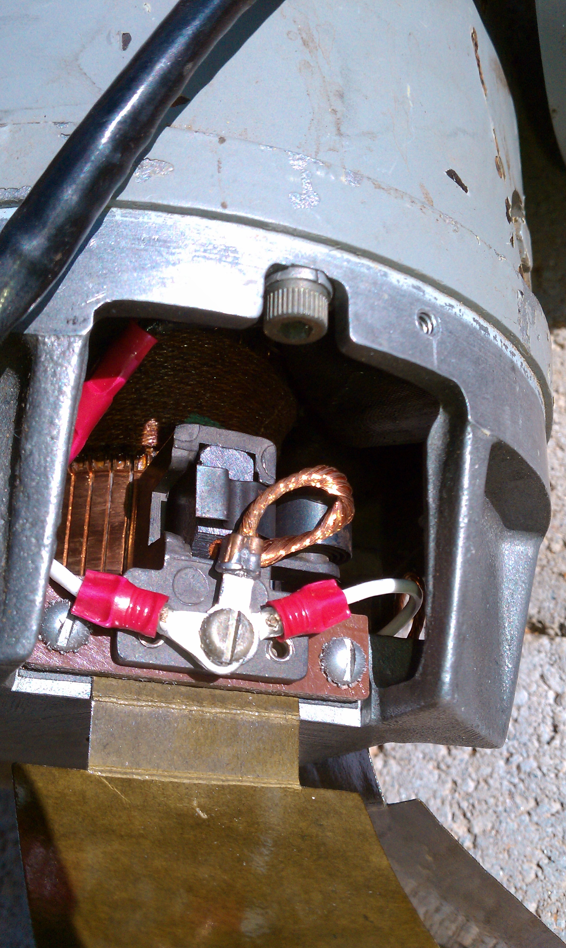

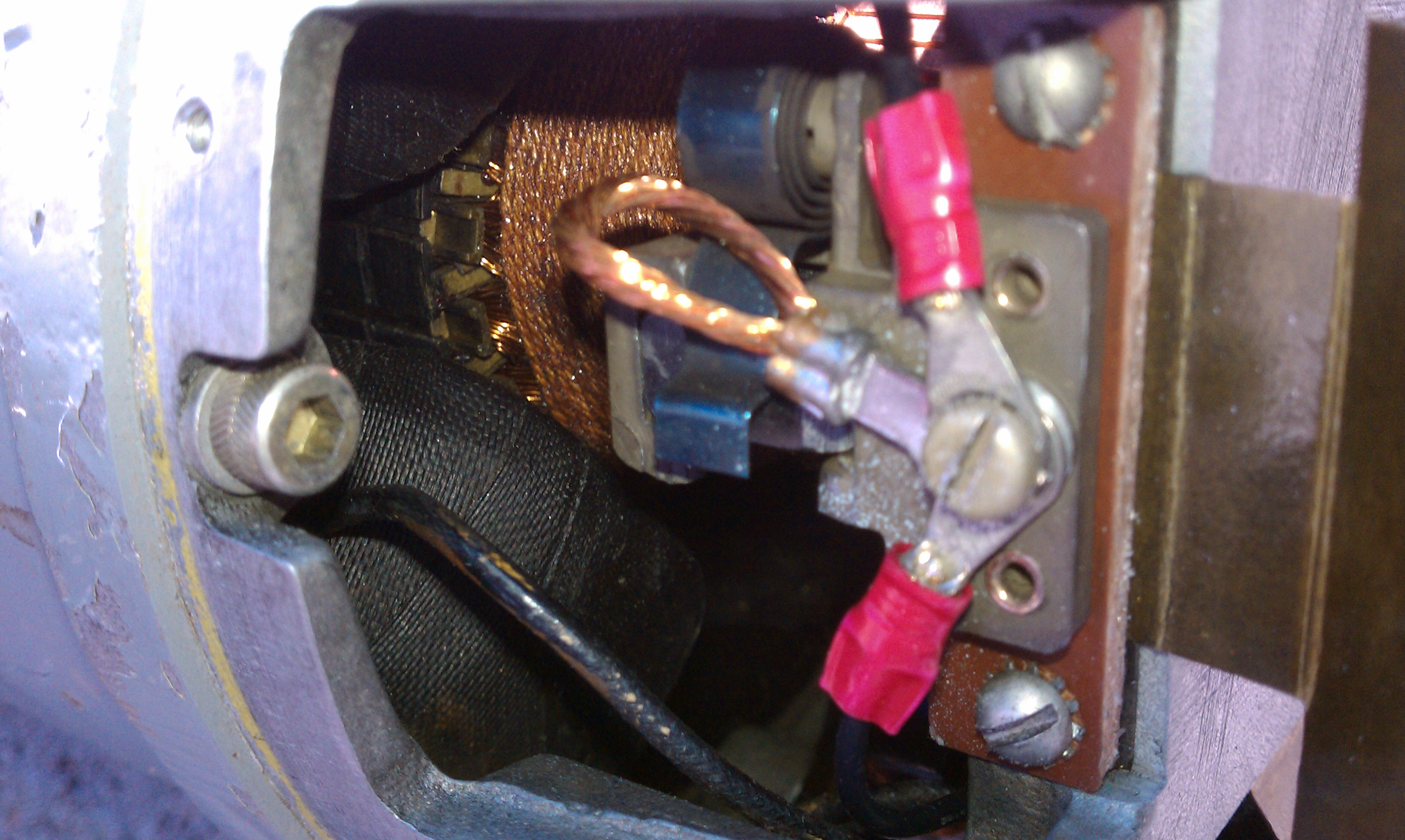

Thanks Ron...here are 3 pics...the tag on the outside says "PSI - Peripheral Support ...a division of MESON Corp" ...i think it is made in the USA...for military. What is your take from the pics? Do i need to post more/different ones?? Also, how exactly do i test the resistance of those leads? I access to whatever meter(s) i need...just let me know what type. Thanks for helping out a noob :)

Good pictures and I can tell you the following. The top number on the nameplate is a NSN (National Stock Number) and you were on target in that it is a piece of military surplus and unless another country uses NSN I would say US military. The bottom number, Contract Number is the contract number the part was made under for the US Govt. The NSN denotes a federal part number which likely had several manufacturers for that same motor and the Contract Number links it to the company whose name you see on the name plate. I couldn't make out the full NSN but maybe with a Google something will turn up?
The motor itself is a brush type DC motor as the brush springs are quite visible and it has 4 brushes. The brushes ride on the commutator of the armature. Likely one wire will go to two brushes and another wire to the remaining two brushes. The brushes with common wires will oppose by 180 degrees if I guess right. The brushes are carbon in the brush holders with spring loading pushing them down on the commutator. I can't see how much wear they have but the commutator looks OK.
So what you need is an ohmmeter to do a few resistance checks. One wire will go to one set of brushes and another wire will go to the other set of brushes. Those two wires will be the A+ and A- I mentioned earlier. They will be a pair.
The remaining pair should show a resistance between them. Those will be the field windings which the armature rotates inside of. There should be no resistance (continuity) between the field winding and the brush leads.
The motor is a variable speed DC motor. Now I may have this backwards but with motors like this (1 HP) I think they use a fixed voltage on the commutator and vary the voltage to the field windings. That may be backwards as I said. I can tell you that using a motor like this for your intended use won't be very easy or practical. :(
<EDIT> On second glance the brushes and commutator look real good and I see one field wire (maybe) that looks pretty thick as in possibly a high current which may imply a low voltage but I don't know. Maybe someone else has a few thoughts? </EDIT>
