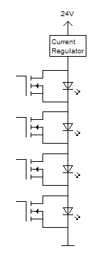

Another idea would be to build a 1A constant current regulator (whether it be a switching design or not) and short circuit the LEDs in a PWM fashion.
You're missing my point, a dimmer is a type of switching circuit. The idea is if you switch the LEDs on and off fast enough your eyes will think they are continiously on and if you vary the duty cycle (on vs off ratio) then you can vary the brightness. Please Google for PWM.
There is no point in building a 1A regulator for each doide when you can just use one regulator, connect them all in series and short circuit each diode to turn it off.
If you really want good efficiency then use a switching constant current regulator. Please check out the link to Wikipedia in my previous post.
