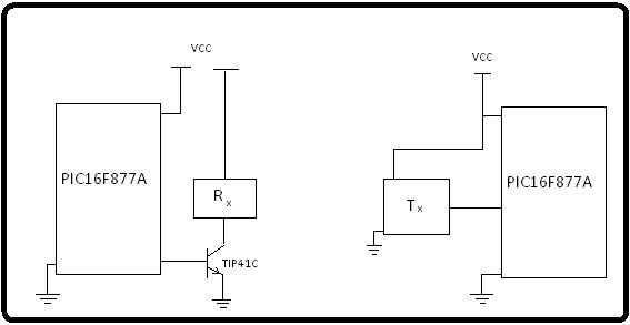

I'm building a low cost weather transmitter with all six weather parameters integrated in one system, fed to a pic16f877a, and I need to send data from it to a nearby pic too, which will transmit the readings into a PC/Laptop (preferably the same PIC), using a pair of 315 Mhz RF module
Question:
1. What would be the best way to transmit data of six 8-bit data via the module? (i.e manchester code, etc) I use an MPLAB compiler, assembly and C.
The diagram of my circuit is attached.

1. Manchester, see Nigels tutorials.
2. USB? An FT232R to your PIC RX/TX pins
3. Something you'll need to write in MATLAB
PS your block diagram makes no sense, why a transistor on the RX module?
Post a detailed schematic.
My bad.... the transistor's supposed to drive the Transmitter. I interchanged the Tx and Rx.
