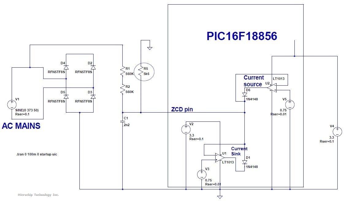

Hello, Will we potentially damage our PIC16F18856 by setting it up to do mains zero crossing detection as in the attached schem?
We have a 40W offline , non-isolated LED lamp. We have a PIC16F18856 in it which has circuitry to do zero crossing detection (ie circuitry inside the micro itself) . Therefore, we set it up as in the attached schem to do mains zero cross detection.
However, we are not sure if this is OK?...after all, the Microchip datasheet and App Note examples never show mains zero crossing detection…but only show examples where the AC source that’s being “zero-cross-detected” has the same reference ground as the PIC16F18856.
……In our case, the AC source being “zero-cross-detected” is the mains, and obviously its not referenced to the same ground as the PIC16F18856.
Do you think we could potentially damage our PIC16F18856 by connecting up the PIC16F18856’s zero cross module in the attached shown way that we have?

Looks as though it should work, albeit with ~1.27 ms delay between actual zero crossing and it being detected.

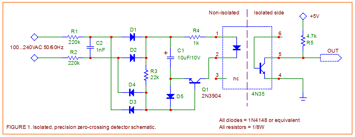

Your circuit seems really extravagant. I just don't see the point. Have you read this app note?
https://ww1.microchip.com/downloads/en/AppNotes/93013a.pdf
Can't you just use another pin with no analog features and add a couple of isolation capacitors for hot and neutral at the inputs of the regular current limiting resistor and diode clamp ZC circuit? Because the ZC peripheral seems to exist, not as an optimal solution for ZC detection, but as a workaround in case a user was cornered into needing to use an analog pin for ZC detection. Do you have no other choice of pins?
I attached some alternatives for use with a regular non-analog I/O . You could modify these circuits by replacing the capacitors at the input with an opto at the output for more safety. I tend to use the top version just because I don't like to rely on the threshold voltage of the digital input and it also clamps the voltage to a lower value, but requires more parts.

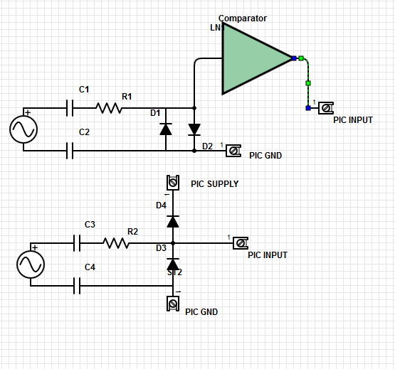

Here's a far better ZCD circuit for your to consider, I've used it in the past and it's extremely reliable:
This circuit is not of my design, and it was posted in a page called www.drexel.net, which seems to be out of line now. Luckily, I had considered it relevant enough to save the image to my library before the page was put down.
