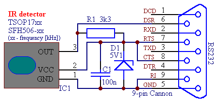

I have a good range of remotes to try it with, so I'm sure one will do the trick. I'm going to attempt to build an RS232 IR receiver to use with my media server - having to get up and press buttons on the keyboard everytime to operate MPlayer is getting tedious. MPlayer has integrated LIRC support so all I need is to build a homebrew device which works with LIRC. Most of the schematics involve PICs which complicates matters for me as I've never used them, but I found one which is remarkably simple. I wonder if it'll actually work?
