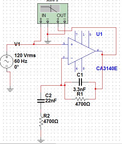

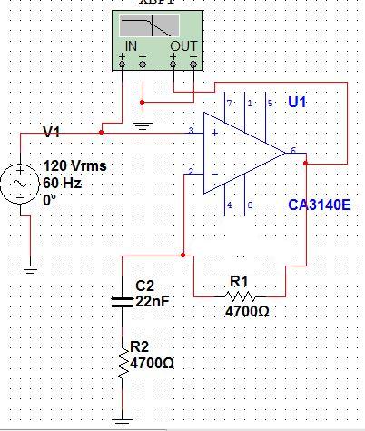

Hi all,
I'm struggling with the following opamp circuit which acts like a filter :
H=1+ Z2/Z1
Z1 = R2+1/sC2 = (s.C2.R2+1)/sC2
Z2 = (R1/sC1)/(R1+1/sC1)= (R1/sC1)/((s.C1.R1+1)/sC1)= R1/(s.C1.R1+1)
H= 1+R1/(s.C1.R1+1) / (s.C2.R2+1)/sC2 =1+ (R1*sC2)/((s.C1.R1+1)*(s.C2.R2+1))
and now things are about to heat up!
H=1+ (R1*sC2)/((s.C1.R1+1)*(s.C2.R2+1)) = (((s.C1.R1+1)*(s.C2.R2+1)) + (R1*sC2))/((s.C1.R1+1)*(s.C2.R2+1))
So the denominator is fine now = (s.C1.R1+1)*(s.C2.R2+1)
now the numerator : (s.C1.R1+1)*(s.C2.R2+1) + (R1*sC2) = s.C1.R1.C2.R2+s.C1.R1+s.C2.R2+1+R1*sC2
now the options are :
: s.C2.(R1+R2)+s.C1.R1.C2.R2+s.C1.R1+1
: s.R1.(C1+C2)+s.C1.R1.C2.R2+s.C2.R2+1
:s.R1.C2(1+s.R2.C1)+s.C1.R1+s.C2.R2+1
none of them can lead to a result as = X( 1+s.CxRx)(1+s.CxxRxx)
Someone who sees something I'm unable to?
Cheers

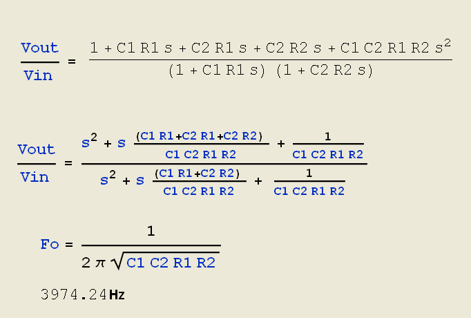

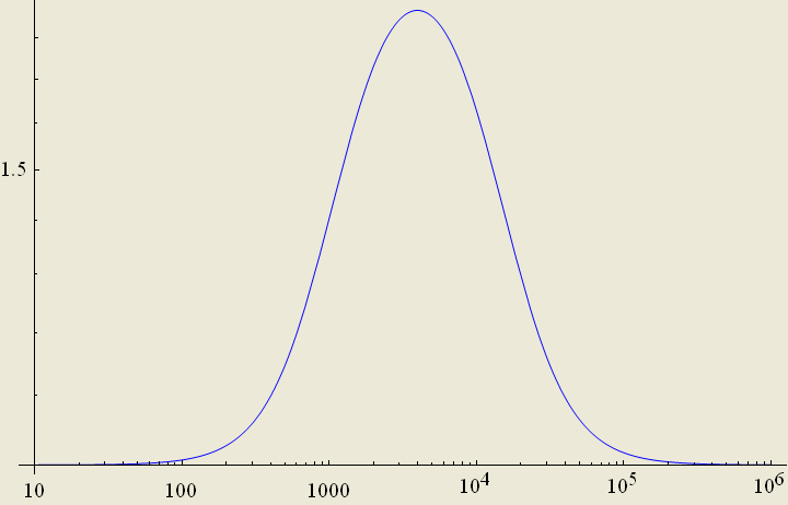

I hired Mathematica program to find the transfer function of your circuit.
And this is what I get
And the plot

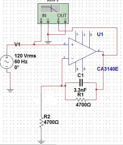

I also analysis this circuit separately
For this circuit
I got one Zero at
[LATEX]Fz = \frac{1}{2*\pi*C2*(R1+R2)}[/LATEX]
And one Pole at
[LATEX]Fp = \frac{1}{2*\pi*C2*R2}[/LATEX]
And for this circuit
One zero at
[LATEX]Fz = \frac{1}{2*\pi*C1*(R1||R2)}[/LATEX]
and one Pole
[LATEX]Fp = \frac{1}{2*\pi*C1*R1}[/LATEX]

Hi there,
First of all i see you dont have the numerator written correctly. It contains at least one term with s to the power of 2 in it making this a second order equation.
As you probably know, you can solve for the roots and therefore factor the numerator using the quadratic formula. This will lead to a little more complicated solution than for the denominator of course, but that's one way to do it. Example:
s=(sqrt(C2^2*R2^2+(2*C2^2-2*C1*C2)*R1*R2+(C2^2+2*C1*C2+C1^2)*R1^2)+C2*R2+(C2+C1)*R1)/(2*C1*C2*R1*R2)
That's not as simple as we would like to see but that's part of a solution in factoring the numerator:
s^2*C1*C2*R1*R2+s*C2*R2+s*C2*R1+s*C1*R1+1
which of course can be written as:
s^2*C1*C2*R1*R2+s*(C2*R2+C2*R1+C1*R1)+1
You might also however take note that all the component values are given in this exercise, so you dont really have to work out the problem symbolically unless of course you want to do that anyway. Numerically it's just a matter of finding the two roots of the numerator and that will give you the required numerical values to use to factor it.
Either way though you can use the quadratic formula to get the results you are after. You're lucky this is only second order as these are much simpler than third or higher order transfer functions.

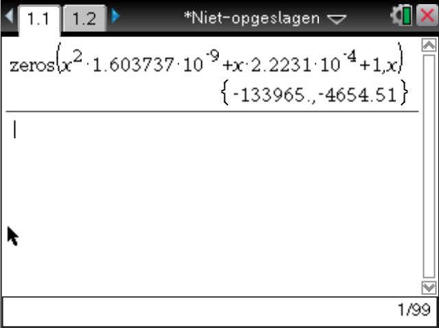

Hello Jony and mrAl,
I have to thank you guys for the work and effort!
I understand the formulas that you guys are using!

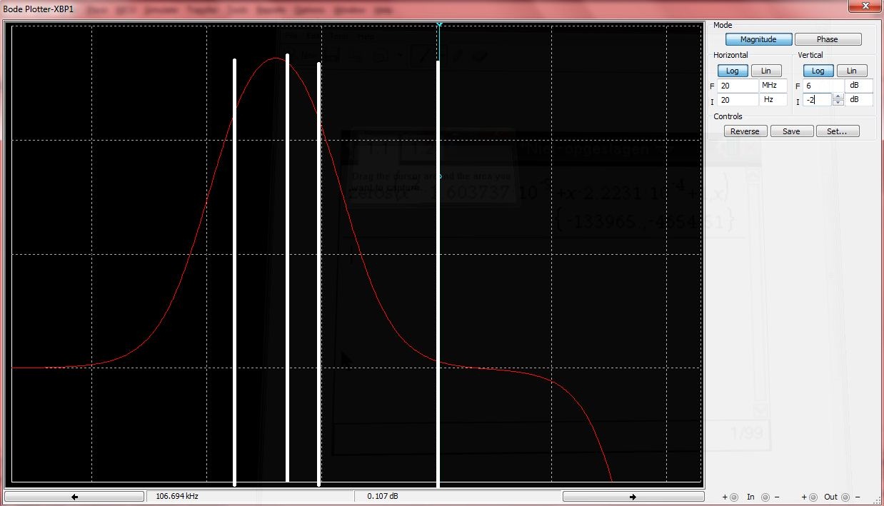

I use the program from texas ( TI nspire) to get the zero's of this second order function :
and then a bode plot:
so the 2 zero's have to be : 133965 Hz and 4654.51 Hz
and the 2 poles : 10261 Hz and 1539 Hz
so then I marked the points of these cut off frequencies:
My question is: do these frequencies even make sense? Because the - 3dB points are not really that correctly?
Or is it because I'm working with a region between 0 dB and 5 dB so it's hard to accomplish these dB's and frequencies?
Thanks for the effort!
kind regards

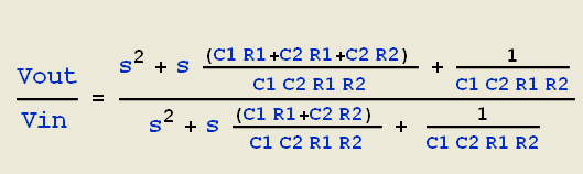

Form your transfer function we can find the Center frequency (mid-band frequency)
s² + s (ωo/Q) + ωo²
01-png.56054
[LATEX]Fo = \frac{1}{2*\pi\sqrt{C1C2R1R2}} = 3.974238KHz [/LATEX]
And we also can find the Q factor
The numerical transfer function look like this
[LATEX]
H(s) = \frac{s^2 + 138620.24500s + 6.23545*10^8}{s^2 + 74145.71244s + 6.23545*10^8}[/LATEX]
And from this we can find two Poles at
P1 = 1.53921665825KHz
P2 = 10.2614399856KHz
And we also have two Zeros
Z1 = 740.788454832Hz
Z2 = 21.3213087495KHz
And how to find 3dB cut off frequencies ?
I don't know. Maybe form Q factor

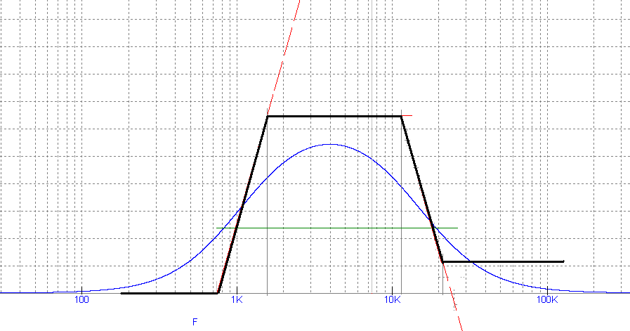

Hi again Sneak,
It depends on how close the poles and zeros are to each other, but you can get a general idea of the response by looking at the Bode asymptotic plot. It's never going to be as exact as a true curve plot though.
In the following diagram, you can see the Bode asymp plot as the bold thick black line, and the true curve in blue, and the -3db horizontal green line cuts the true curve at the -3db points. You can see the Bode plot isnt too far from the true 3db points but is quite a bit higher than the true curve.
You might want to try this yourself and verify that i drew the Bode plot correctly as i dont draw Bode plots any more because the computer software can draw the true curve much faster and of course it is more accurate.
The horizontal dashed lines are spaced 1db apart, with the lowest line being 0db.
