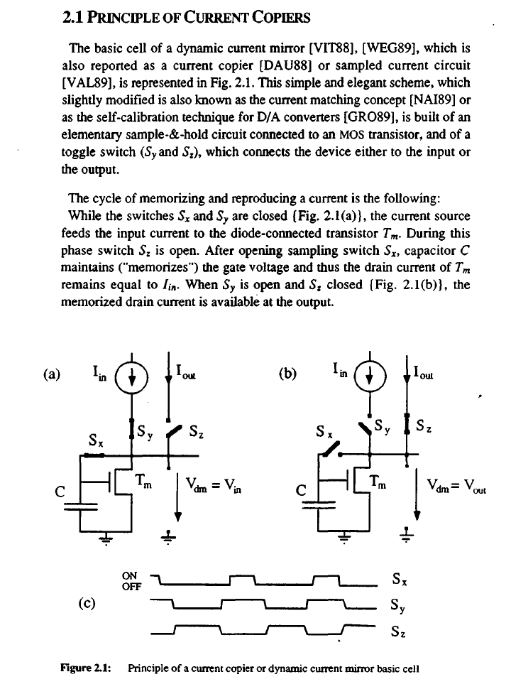

Current Mirror and Current Copier....
Never hear of a current copier.
Never herd of a current copier. Probably the same thing just a strange name.
I would guess that a "current copier" provides a current in the same direction (source vs sink) as the reference current. A current mirror supplies a current in the opposite direction of the reference current. Never heard the term "current copier" before.
EDIT: See link:
https://www.electro-tech-online.com/custompdfs/2009/11/EPFL_TH890.pdf
Excerpt from above link:
currentcopier-png.35379
