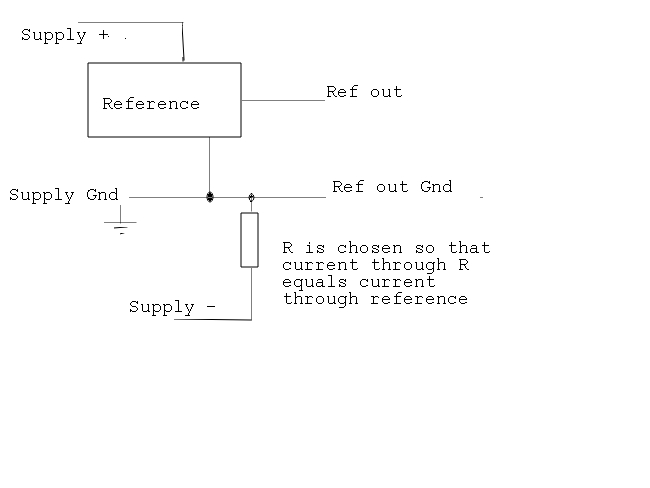

Suppose I have a voltage reference and some associated components connected between a supply and ground. Now imagine I have a resistor connected between ground and a negative supply to minimise the current actually flowing from the reference circuit through the rest of the ground. (I know that HP use or used to use this arrangement).
I was wondering what a better way might be to obtain the same or better result and not depend on precise resistor selection. A current mirror was the first thing to spring to mind, but then the output side has to be going negative.
Thoughts, anybody?

I didn't phrase first post very well, did I...
Ok, the idea comes from a reverse-engineer someone posted on volt-nuts forum (I think that's what it was) some years ago, of the reference circuit from an HP DMM - might have been 3458 but I'm going from memory - it was a really good one anyway.
The board had a precision reference, op-amp and supporting components. Lets assume a shunt reference for argument's sake. Might have been LTZ1000.
What I found really interesting was a resistor going from ground to negative supply, the only purpose of which must be to match the supply current so there is no (or very little) current flowing through this circuit's ground connection to the supply.
I imagine this is to eliminate errors due to the resistance of the ground conductor. I suppose they would have used an ADC with a reference ground and connected it to this point, but I'm wildly speculating here.
So it's creating a virtual ground which is connected to real ground anyway.
It's fascinated me ever since and I started wondering if I can make use of the idea but adapted to tolerate DIY-grade parts by using some kind of mixed-polarity current mirror in place of the resistor.
Like this:
So it basically simulates a kelvin connection? You could just actually use a kelvin connection (or star ground as previously suggested).

Well, not just R418 seems useless. The entire -15V supply is there for no other purpose than to power R418 so maybe that really is the case.
You could simulate in LTSpice and measure the currents with and without to verify if you're really curious
I found a photo of the back of the board. That resistor actually goes directly to pin 7 of the ref.
