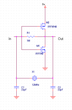

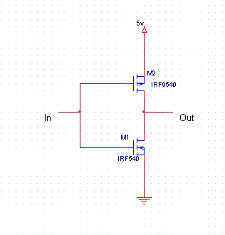

Thank you all for replies. I built a cmos inverter as shown below:
This cmos inverter worked as an logic inverter very well. But when I tried to apply to crystal oscillator as below. It did not work at all! Could anyone here explain why ? Thanks all.

Those power MOSFETs have way to much gate capacitance to work in a crystal oscillator circuit.

Yeah those MOSFETs are not suitable for use in an oscillator like that. You should really use the hex inverters or something like that, and follow the directions of a good app note on crystal oscillators like that from Microchip.
There are a few issues you should be aware of, depending on the accuracy you need too and what kind of crystal you are using as it is even possible to burn out the crystal if it is not done right.

An oscillator has to start up to work. When it is starting, the voltage on both the input and output are near the middle, and the inverter runs in its linear region, and takes more current than when full oscillation has started. The resistor is there to hold the voltage in the linear region during starting, while thermal noise is amplified by the inverter and filtered by the crystal until the amplitude eventually builds up. Starting takes several thousand cycles, so an AT-cut fundamental crystal will take 0.1 - 1 ms, while a watch crystal takes a few seconds to start.
The power MOSFETs have a large gate threshold voltage, so there will most likely be a dead area in the middle when both MOSFETS are off. If not, and there is a cross-over point where both MOSFETs start to turn on, and with those MOSFETs you could get lots of current though the MOSFETs, shorting the supply. Either would stop the oscillator starting.

I agree that the power Mosfets will not work in the 5V crystal oscillator circuit:
1) Gate capacitance is thousands of times higher than in an inverter IC.
2) The gate-source threshold voltage is much too high for a 5V supply, a 10V or 20V supply would be better. Many power Mosfets DO NOT turn on when the gate voltage is only 2.5V. The threshold voltage in the datasheet shows 2V to 4V when it barely conducts only 0.25mA. An ordinary CD4xxxx Cmos inverter works perfectly with a supply as low as 3V and many 74HCxxxx Cmos inverters work when the supply is as low as 1.5V (a 2V supply is guaranteed).

Most Design Engineers and Techs dont know that the Ciss * RdsOn product for a given family of Mosfets e.g. lithographic size is constant . Thus your RdsOn is too low causing Ciss to be too high eg >1000pf loading the input 33 pf cap in parallel and severely attenuating the Xtal feedback signal in parallel high impedance mode.
In CMOS gates, we call this simply parasitic junction capacitance which lowers the resonant frequency by as much as 25ppm say roughly, when the input is 5pF and the Xtal load capacitance is rated at 16 pF. But if you load it with 1000pF it attenuates the input more than the voltage gain of complementary MOSFETs. In unbuffered (UB) single stage CMOS gates had a gain from 10 old to 100 new for 74ALVC2xx types. Standard gates are 3 stages with a minimum gain of 1000 which can be too high for many crystals with overtones or harmonics.
Therefore, if the Ciss of the MOSFET was at least 100 to 1000x smaller and RdsOn was 100x bigger, it may have worked.
After about 10~20ms the input DC reaches V/2 and then the AC envelope grows according to inverse bandwidth where T= 1/2 * 1/f-3dB
Another factor is technology in last decades has made quartz crystals smaller , most that have been microsliced and have shrunk in volume orders of magnitude, which lowers the Q, quality factor or gain and rated load capacitance, so 33pF may not match your crystal, unless you have specs. It might only be 12 pF depending on supplier, thus two 24pf or a 27 out and 16pf input may be better, depending on circuit input capacitance.
