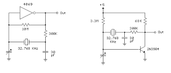

Hello Everybody,
I build this crystal oscillator circuit like the diagram below. When I use IC HD74HC04 of Hitachi Semiconductor or 74HC04 of NXP semiconductor (formerly Philips semiconductor). It works well. But when I use SN74HC04 of Texas Instruments. It does not work ! Could anyone give me any suggestion ? Thanks.

I though you need a voltage across the crystal for it to work. Looks like a ground on both sides. How do you know it works? I found this circuit on the crystal oscillator circuit page. Many of those circuits dont work.
All of those circuit topologies do work, if the component values are correct for the crystal.
Crystals specify a certain capacitive loading. Read that from the data sheet.
The 32.768Khz units are not crystals per se but tuning forks. Although its model is similar to that of a crystal, they can be easily damaged with overdrive. I know, I've destroyed a few of them. A large value series resistor (300k in your schematics) or employing a lower supply voltage (1.5 to 3v) is required.

Are you building on a printed circuit board, on a solderless breadboard, on perf board with point to point wiring or what? Solderless breadboard adds a lot of capacitance to the terminals, which might impair function.
Having made and designed crystal oscillators for a living for nearly 20 years, I found that you should always use unbuffered inverters as the main oscillator. You might want to add some resistance between pin 2 and the common point of C2 and the crystal.
You might be getting the crystal oscillating in 3rd overtone mode, at around 36 MHz. The propagation delay of the inverters is around 7 ns, which is short enough that you could get 3rd overtone oscillation.

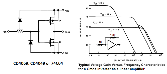

The vendor sensitivity on bandwidth variations on HCMOS has existed since I started using them in 1973.
U unbuffered types have always been recommended for many reasons as SchmittTrigger and Diver300 indicated.
The series R is critical >=5V to avoid exceeding 50 uW losses in Xtal.
The U inverter has adequate linear gain of >=10
The 3 stage standard inverter has gain of 1000+ is excessive.
An ordinary CD4069, CD4049 or 74C04 Cmos inverter has only one stage.

I think the "U" in the CD4069UB part number is something new that was added because there is not and there never was one that has 3 stages and is buffered. Remember that RCA invented the 4000A series Cmos and the buffers were added later to fix problems but not on inverters.
