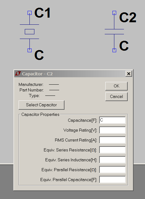

jpanhalt ive not figured ho to make crystal out of cap for qucs cant find a crystal but im sure i will figure it out lol
be80be
In LTSpice, there is nothing to make. Crystals and capacitors are electronically the same. The only difference is a tarted up symbol for the crystal:
You select the same variables for either. I don't know in qucs whether you have the same choices for a capacitor. If you do, it will work for a crystal too. Unless you know the inductance and resistance values, you can do a lot of trial and mostly error before hitting on what works. That is where one of the online calculators might come in handy in addition to a representative datasheet.
