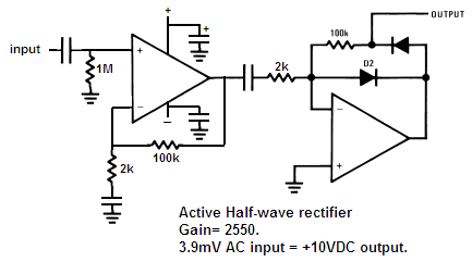

I did it now with this rectifier circuit.
