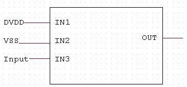

I'm looking for a low cost, low consumption device that will perform this:
VDD = 3.3V.
VSS = GND (0V).
Input = Analog input.
OUT =
VDD if Input is equal to or higher than 3V.
0V if Input is lower than 3V.
Thank you.

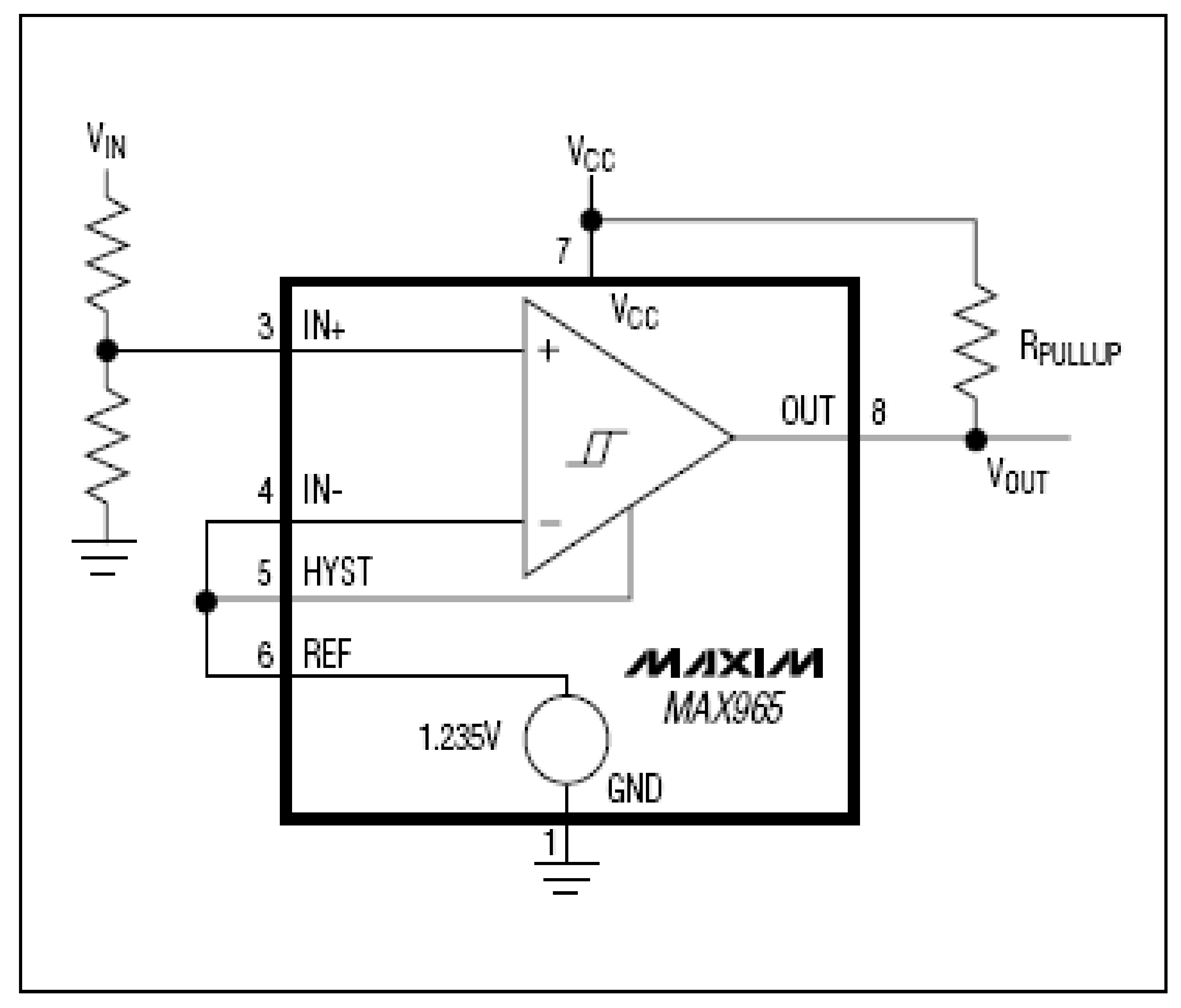

LM311, LM393, LM339.
These are comperators, 1, 2 and 4 parts in one housing
Problem with some comparators they dont work correctly when the threshold voltage is close to the Vsupply.. that is Vs-1.5V approx.
How accurately do you want the detection?
Use a set of resistors on the front-end of an NPN transistor.
Use a two-resistor attenuator on each input (four resistors total) to reduce the voltage below the common-mode voltage range of the comparator.
Maxim has a wide variety of the type of device attached. Adjust resistor voltage divider so that 3 Volts at Vin results in 1.235 Volts at the IN+ of the device.
The MAX921 is a similar device that doesn't need a pull-up resistor, and appears to be more widely available.
The devices consume a mere few microamps and cost around $1.50 in unit quantities.
Maxim is very generous with free samples. Just go to their website and click on "free sample" .
