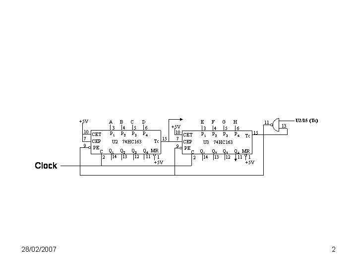

The attachment is a circuit I designed, built and tested some time ago.
It can be configured to divide by any value between 1 & 255 inclusive simply by applying the appropriate levels to the A ~ H inputs.
I wanted it to count at 20 MHz, hence the NAND and the Tc to CEP connection. For lower clock rates, you could connect Tc to CET and use an inverter from U3/ Tc to the PEs

The ugly part of being asynchronous is that when the output is transitioning between 0111 and 1000, there's a chance that the value 1010 or 1001 will appear on the outputs for some amount of time. This would cause the a premature load, causing some counts to be skipped.
The simplest correct workaround I can think of (if hell-bent on using this part) requires another D flip-flop along with the NAND gate for decoding and an OR to gate the /LOAD line. The wrong (but fun way) is to just hack bit 3 to transition slowly with some extra loading :)

Can't argue with your circuit, no problem, nice and glitch free.
Lets hope the OP lets us know how he gets on with his project.
That's why I suggested a synchronous load. See the circuit I posted earlier.
