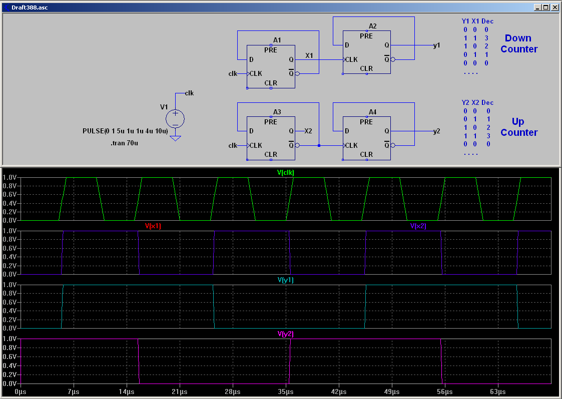

My understanding is the OP is not asking for a conventional binary ripple counter, but a 'counter' as drawn in his earlier posts.
ie: the 2nd F/F clock is derived from the 1st F/F Q0 output.
I have posted a sim of this version and explanatory text.
E
Added text.

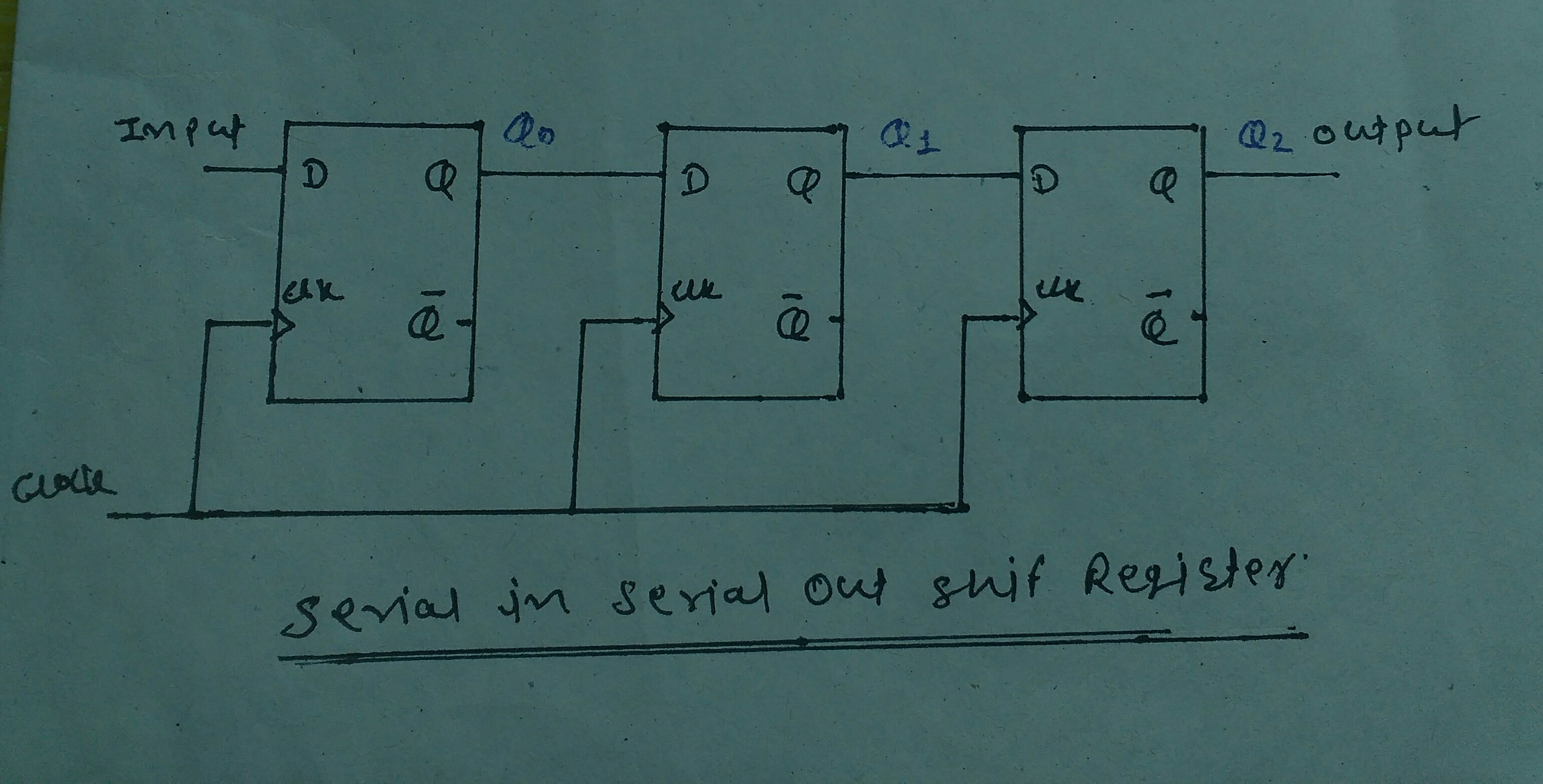

2 bit Ripple counter
4 bit serial in serial out shift register

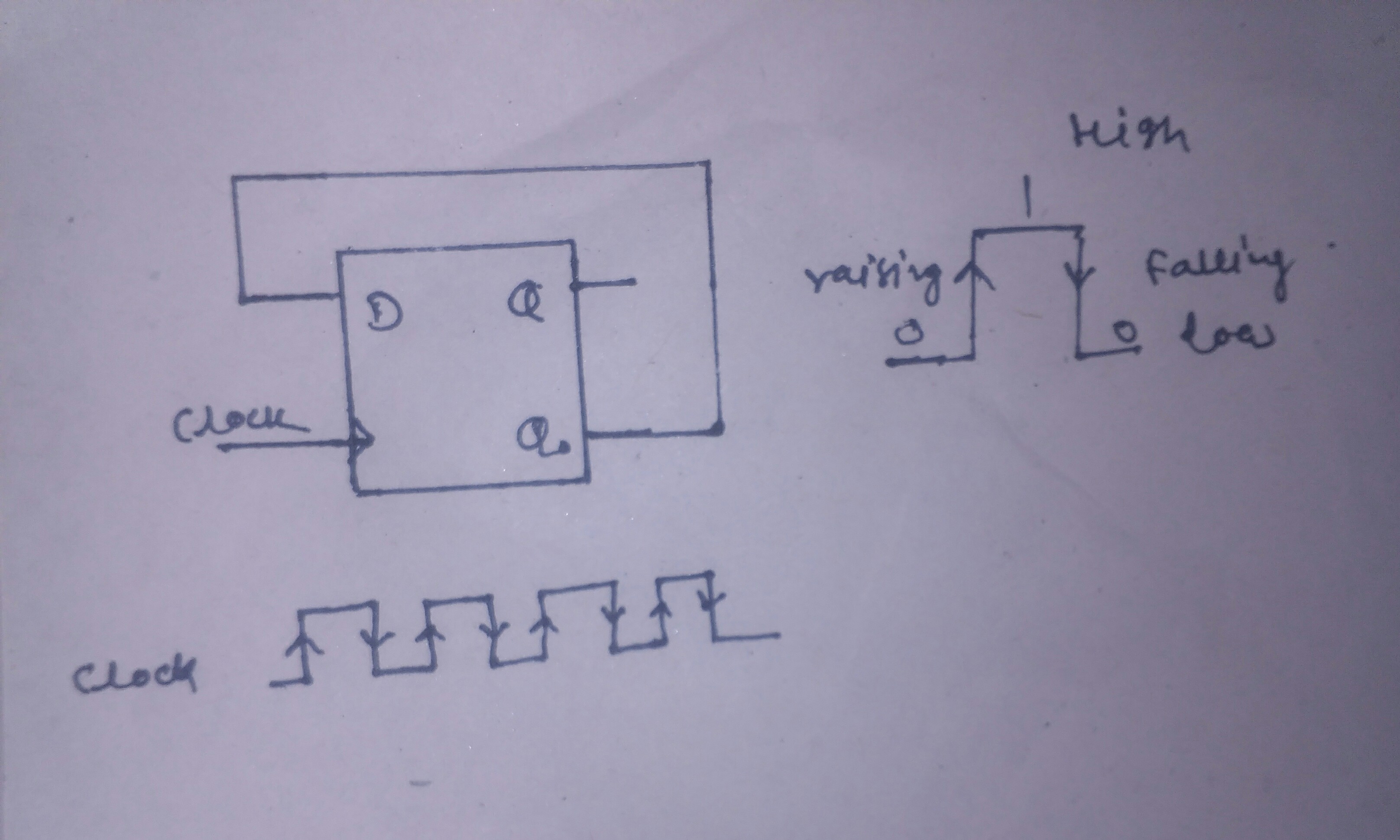

Yes. I have questions but I will ask later. First I have questions for below images
When clock low, output does not change
When clock raise, output will same as input
When clock high, output does not change
When clock falling, output does not change
This is logic to understand D flip flop. D input is connected to inverted output. So we don't know the input data weather it is 0 or 1. If data is 1 than output will 1 means high on raising edge. And if data is low than output will low means 0 on raising edge. So how can we say that the output is high or low on the raising edge When we don't know what is input data? .
Please clear the doubt
The Clock changes the state of the F/F ONLY on the High rising edges.
The small triangle on the clock shown on the symbol of the F/F means its a High Going Clock F/F.
When the Clock is a steady High or Low the F/F is not switched.
The Clock will Set the 'Q' output to the same state as the 'D' input.
So when the /Q is connected to the 'D' input , on every clock pulse rising edge the F/F will switch over.
The 'D' input must always be connected.
For example if you connected the 'D' input only to +V , a logic high, after the 1st clock pulse the 'Q' will always be High and never change for further clock pulses.
For example if you connected the 'D' input only to 0v , a logic low, after the 1st clock pulse the 'Q' will always be Low and never change for further clock pulses.

vead, you will get nowhere if you do not listen to what we say. Your first diagram is not a ripple counter. In a ripple counter, made with positive edge triggered flip flops, the /Q output of each flip flop goes to the clock input of the following flip flop. If you will not or cannot accept this fundamental concept, I will leave you in confusion. This thread has already wasted a lot of time arguing to and fro about a simple and fundamental couple of concepts that even the most basic book on logic design describes.:wideyed:
spec
Hi vead,
Eric has given a very clear description with his diagram of how YOUR circuit works in post #6 and I have described it in test in post #9 We have both pointed out that YOUR circuit is not a normal ripple counter as you have the clock input of the second flipflop connected to Q output when it should be connected to the NOT Q output for it to be a normal ripple counter. In your post #31 you say "the output of first flip will be input for second flip flop" The input (D input) of both flipflops is connected to their own NOT Q outputs. The Q output of your first flipflop is connected to the clock of the second flipflop. As a result the second flipflop will change state when it's clock goes from LOW to HIGH. I think yoau may be missing the point that the change occures on the LOW TO HIGH TRANSITION of the clock. It does not change state if the clock is at a steady low or steady high. It also does not change state on a HIGH to LOW transition of the clock.
Les.
...Your first diagram is not a ripple counter. ...
Yes it is a ripple counter. It just happens to be Down Counter instead of an Up Counter. Look at this for an explanation:
The "Dec" column in the state tables is just the "decimal encoded" value of the two flops, with X as the lsb and Y as the msb... Obviously, X1 behaves identically to X2. Note that I didn't make any attempt to initialize the two flops to any particular state. These are the "default" initial states that LTSpice comes up with...
Both counters divide the input clock by four, so it doesn't matter which connection is used if this is the goal... It only matters if you need to implement a specific counting sequequence.

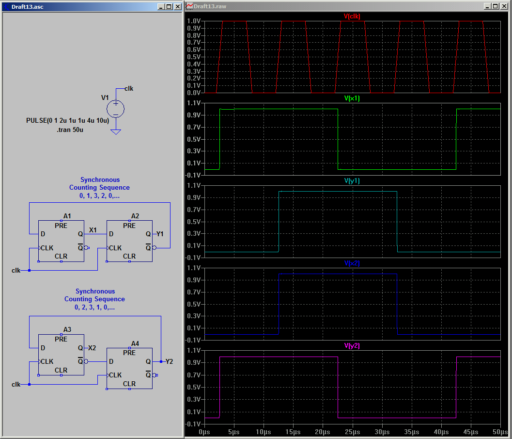

So how about these two? Note that they are topologically identical; the only difference is how I labeled X and Y...
2 flops can have at most 2^2=4 total states. How many can 5 have? Asking about states here, not sequences...
