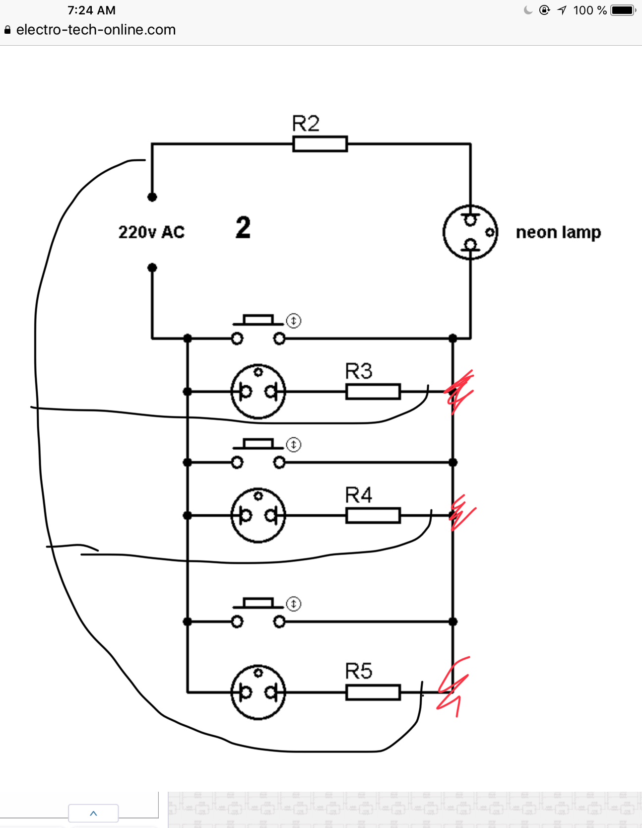

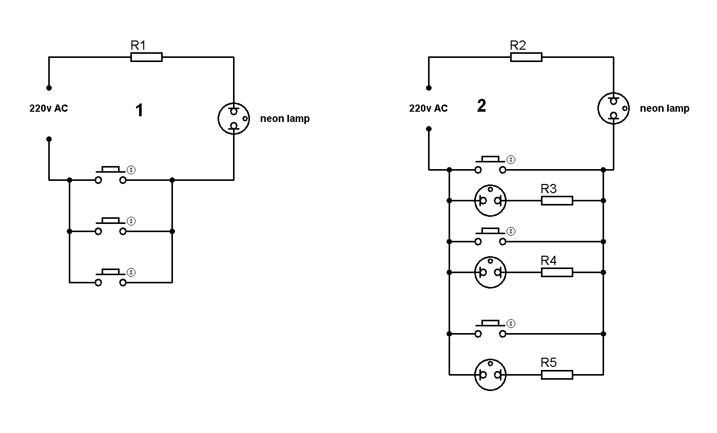

i need a neon lamp to be on when any of parallel buttons pressed .
i test circuit 1 it works as i need.
but if i used buttons with their indication lamps as in circuit 2 the neon lamp always on even any buttons not pressed.
could anyone explain the problem ?and how can i solve it ?
The current from the three indicators have enough current in total to lite the single lamp.
The indicators shouldn't be in series with the lamp, they should be in parallel as follows...
(Remove connections covered in red, add those in black.)
With all switches open you will have current in R2 and bulb. and (1/3 current in R3) + (1/3 current in R4) + (1/3 current in R5 and bulb)
Almost true: In circuit 2 you have R2 bulb, R3 bulb. This puts 1/2 line voltage on each bulb.
Is true: Circuit is R2---bulb---(R3 || R4 || R5) (R3 and bulb) is parallel with (R4 and bulb) is parallel with (R5 and bulb)

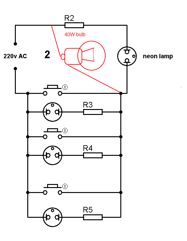

I don't understand what you are trying to do. Here I added a small light bulb. Now the "neon lamp R2" will be off when all switches are off. AND All switch lights will be on.

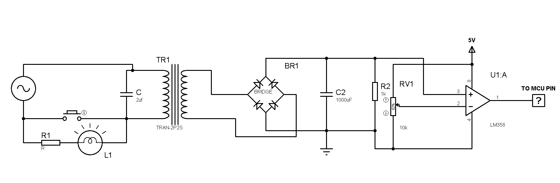

The idea of using the timer output to remove the power to the push buttons will work with any of the suggested loads. (Resistor, lamp, capacitor, or contactor that takes a large enough current so it does not pull in due to the current through the neons in the push buttons.) (I only thought of that idea yesterday to get round the heat produced with a resistive load if a push button was pressed for a long time.) I would personaly use the transformer method for isolation with an X or Y rated capacitor for the load. In practice I would use four 0.47 uF "contact suppressor capacitors" connected in parallel. The transformer method makes it easier to set the switching threashold from the DC voltage (After rectification) from the low voltage secondary. (12 or 24 volts) A comparitor circuit or a small relay with a zener diode in series with it's coil could be used.
Les.
Almost right. You would only want the trigger signal when the voltage across the primary was close to 220 volts. So if the transformer had a 12 volt secondary the voltage across C2 would be about 15 volts when the primary voltage was 220. (12 x 1.414 - (2 x 0.7)) You would need a potential divider to drop the 15 volts down to 4 or 5 volts otherwise you would not be able to set it trigger above about 75 volts on the primary. You could probably get away with using a 1 uF capacitor (Or a 3.6 K resistor which would reduce the power disipation to 13 watts when a button was pressed.) This would slightly reduce the brightness of the neons in the push buttons.

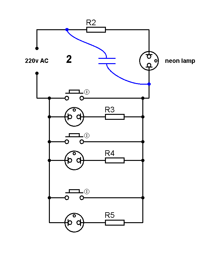

Can you do as in the attachment, connect a capacitor like that?
