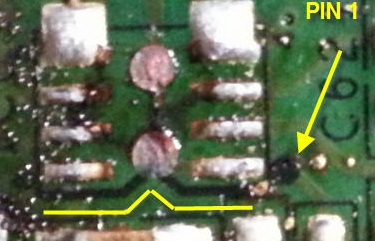

In the first picture the destroyed L6561 can be seen, however, since it burned I cannot see any labelling on it, even under a microscope. I have a new replacement L6561, but what is the correct orientation?
sometimes the top of the chip will have an indicator such as a dot or a tab,
since you have schematic another thing you can do here is trace which node leads to transistor Q654, that will tell you where pin 8 is, and the rest will fall in to play
From the pcb silk screen markings in the 2nd picture (with the chip removed ) pin 1 is bottom right. the marking on the new chip, either a small dot or a small indentation in the case will indicate pin 1.
