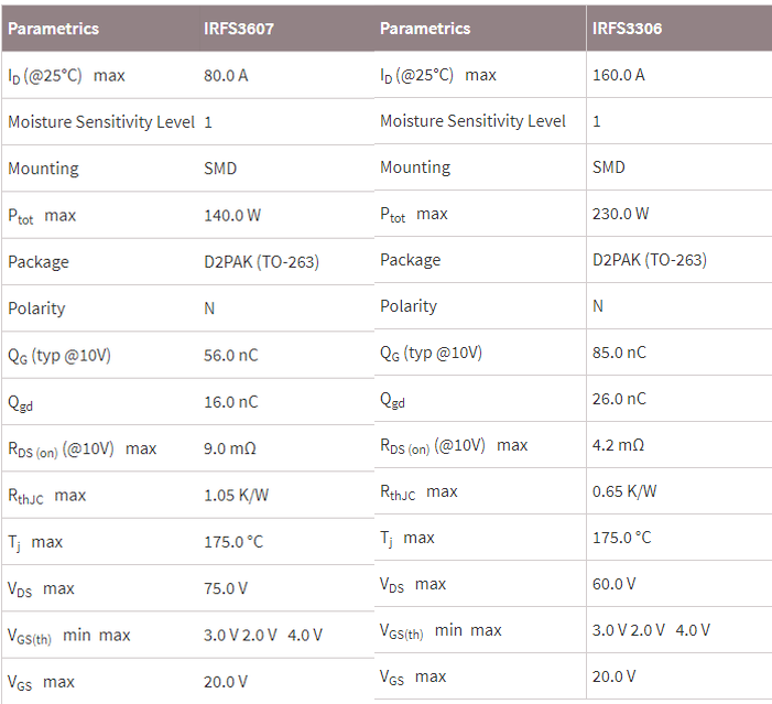

Would you agree that IRFS3607 are a suitable replacement?
If it's blown a pair of 160A devices, ones with half the rating don't seem a good idea to me....
There is a place on ebay selling the 3306; possibly worth a try, at the price?
Or Farnell have some in stock that are pretty close to the originals:
Okay, but if I really believe that 160A capacity is required in service, then I can double up the 3607's. Correct? (But I don't think it should be necessary.)
The math goes like this. 7x2200mAh 15.5Ah total. Advertised maximum runtime for this model was 60 minutes; but as level 3 (turbo mode) was the only level truly effective on carpets, I did my own test (back in 2016 when I brought it) and can atest that it ran for 27'43" from fully charged to cut-off. (And another 5 or 6 minutes after waiting for 10; but that's irrelevant here :) )
For me, that's proof that in normal use it draws no more than 30A. 80A seems more than enough overhead.

Re. the FETs, remember that a basic DC motor can easily take 5 - 10 times normal running current at the instant it starts, or when stalled.
I'd always go for higher rated devices if the originals failed, just to try and avoid more repairs in the future.

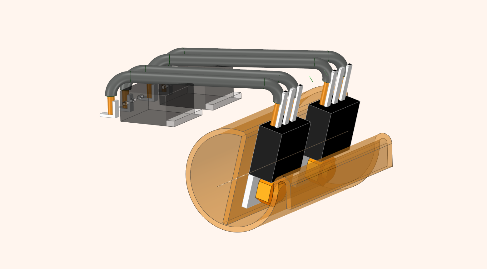

I will not be able to remove the original mosfets -- which have their heatsinks flow soldered to the board -- from the board. I don't have the equipment or the skill. And there is not enough clearance to mount them above the originals, even without the need for an additional heatsink. I will therefore need to mount them off board and attach them via flying leads.
To that end, the plan is to mount them to a homemade heatsink (constructed from a piece of copper pipe), something like this:
The reason for the shape of the heatsink is there is an adjacent spare 18650 slot in the body of the device which will make a convenient place to put the heatsink where it will be in the airflow from the motor:
Understood. I was considering the 3607s because I ordered a BMS board for another project a couple of weeks ago and it should be arriving soon. It has 4 3607s TO220s on it. I was considering stealing 2 from that for this purpose and then replacing them at a later date.
If I needed to double them up, that is also possible:
