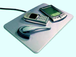

I think the Russians cheated with their "Single Wire Transmission of Power". Look how close the receiver's antenna is to the (metal?) wall. :lol:
The "Splashpad" is just a coil in the mousepad and another coil in the mouse. They make a transformer through a very small distance (less than 1mm) of air.

I don't think an RF signal is sufficient to charge anything, so I'm afraid coils are out.
I have an idea. It may be temporary, but charge up a bunch of capacitors, and when you need a battery, use a capacitor every 5 or 10 seconds.
or go with my other method of using solar panels.
I do know that both ideas are ridiculous, but hey, at least it is better than no power source.
You don't need RF to use coils to couple power from a mouse pad to power the mouse on top of it. An ultrasonic frequency would require
coils small enough. The magnetic coupling is good because they are so close to each other.

The primary coil is in the mouse-pad and the secondary coil is in the mouse which is spaced a very short distance away. It is a transformer with a small gap.
audioguru said:
epilot said:
i would like to know more about ultrasonic power transportation
but this is not ultasonic, that is a induced way!
like a primary and secondary coil
but i thought you was talking about ultrasonic waevs using ultrasonic mic and...?
They use an ultrasonic high frequency so that the transformer halves are small and light-weight.
