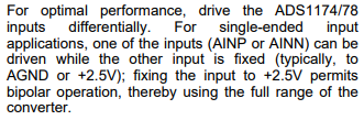

Looking at the ADS1178 data sheet, it would appear that the main disadvantage of using the input single-ended and not differential, is that you only get half the dynamic range for unipolar signals, so the maximum output is 15-bits instead of 16.
If that's not an issue in your application then single-ended operation should be fine.

That only if you tie the - ADC intput to ground. If you tie it to mid-voltage then you should be able to maintain the full range.

That's only for a bipolar (±) input and I believe your input is unipolar.
From the data sheet:
Unless I'm missing something, I don't believe that they are talking about bipolar voltages as referenced to ground when they use the word "bipolar" here. I think they're talking about the ability for both the + input to be more positive than the negative input as well as the - input to be able to be more positive than the + input. The ADC's input range can only accept signals between AVdd and GND so I don't see how it could ever actually accept a truly bipolar input voltage.
