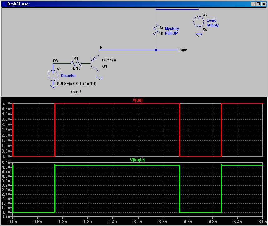

I used a dremel cut off wheel to remove the entire relay portion of the receiver PCB as they will not be used and saves space inside the device. The data pins D8-D11 are normally logic 1 (5V) but when a button is momentarily pressed the corresponding data pin is logic 0 (0v) then resumes back to logic 1 (5V) as the button is released. How do I tie the switch 5v signal wire to the other switch gnd momentarily then resume back to 5 volts?
What is the value of the pull-up resistor to +5V on the Signal wires? The data r+eceiver likely has a very whimpy ability to sink current, and may not be able to overcome the current being sourced by the pull-up resistor. You may have to use rewire the transistors to use them as an emitter follower.
The application is a Volcano Vaporizer DIGIT with the Atmel ATMEGA16L-8AU microcontroller, I hope that helps...
Not a bit. You will have to look up the schematics.
Here is what I am trying to say about how you should connect the PNP transistors to interface with your external logic...
Oh okay, now I understand. The collector of the BC557 is GND so when D8 gets pulled low, the emitter is grounded from the collector? I hope i'm understanding this correctly.
Yes, the PNP is used as an emitter-follower. The emitter resistor is the pull-up inside your micro-controller board.

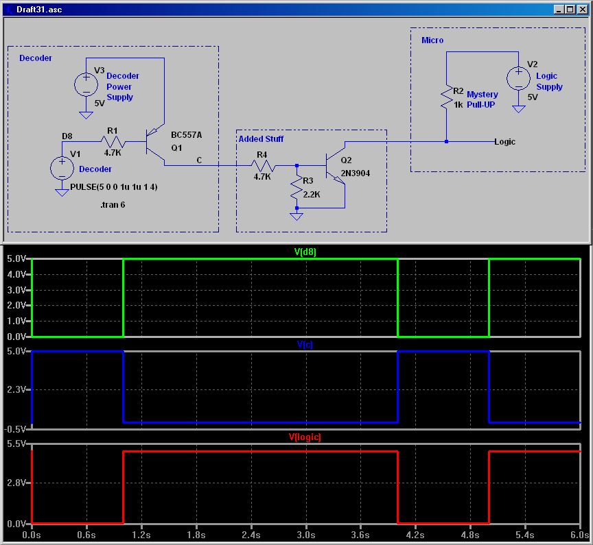

Uh Oh, you changed your request for the two transistor solution. I was working on it while you changed your request.
MikeMI you are AWESOME!! I will definitely use the 2 transistor solution as it most resembles the volcano's normal mode of operation and makes me feel better not sending a slightly higher voltage to a piece of equipment that has no schematics available for a good reason, so people don't copy a $500 device. Again thank you so much!
Just wanted to do a follow up and say that the circuit works flawlessly. I went ahead and put a 1k ohm resistor in series between the NPN transistor's collector and the microcontroller's signal wire. The volcano switch gnd is connected to gnd of the decoder's power supply.
