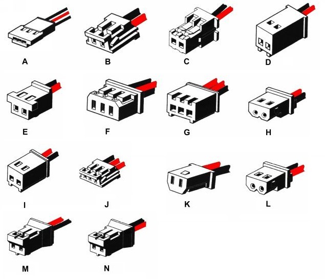

Also, the battery I have is 9.6v 2200mAh Ni-MH. Its connector is one I've never encountered before - like the one marked 'L' or 'H' here. Anyone know what this connector is and where I could buy a female version of it?

I've decided I shalln't use that power supply to charge it, but the adjustable one I have that goes to 12v. My last qualm is about the connector on the battery, I have never seen one similar before. It's like type 'L' or 'H' here. At the very end of it, it's 6mm wide. Anyone know what this is?

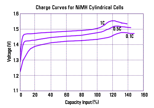

A 9.6V ni-MH battery is 12V when fully charged. The charger needs maybe 3V additional so a 15V supply must feed the charger.
The 300mA max allowed current from the variable 12V supply is barely enough to charge the 2200mAh battery overnight and does not have enough current for amplified speakers.
How does that make sense? Surely a 9.6V NiMH battery is 9.6V when fully charged...
Edit: I just checked my 9.6V NiMH battery (it's pretty new and hasn't been used yet, so it should be fully-charged); it reads 10.4V. I have often checked "1.2V NiMH cells" and found they're at 1.3V, so the 800mV difference in a battery comprised of 8 1.2V NiMH cells makes sense to me.
A 9.6V Ni-MH battery has eight 1.2V cells. Each cell averages 1.2V when discharging.
The voltage reaches 1.5V per cell when charging.
I charged some cells yesterday and now they measure 1.38V each so eight would measure 11.04V.
Here is a charging curve for a Ni-MH cell:
