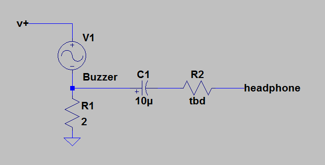

I have a TMB12A05 buzzer on a board. I looked it up and it takes 5v to energize it.
I am wanting to replace the buzzer with some sort of sound chip so I can pipe the sound through a headset.
Can someone point me in the right direction?

Ohhhh, I see. I guess you would just desolder the buzzer two pins and solder in two wires connected to a cable with a 3.5mm audio jack. Might need to stick an attenuator if it's too loud or an amplifier if it's too quiet, but it's simple enough to just do this first and check. Don't be wearing your headphones when you first test it.
I'm unsure how friendly a piezo buzzer, which is probably be run off a DC square wave, would play with your head phones. You might want to stick a large DC-blocking capacitor (47 or 100uF maybe) in between one of the wires so your headphones get an AC square wave. Make sure you get the polarity the right way or the cap will explode.

That's because you don't need a sound output chip. Just remove the buzzer from the board and wire headphones in place of the buzzer's two connections. If it's a huge buzzer like a truck then stick a resistor inline (maybe even a potentiometer so you can adjust volume) with the headphones so you don't blow your eardrums out, and don't do the first test wearing your headphones. Also, don't forget the inline DC-blocking capacitor mentioned earlier.
Other option is to leave the buzzer in place, put a 1-5Ω resistor in series with the ground side, and use an audio-coupling capacitor to couple the audio to the headset circuit... You can add a resistor in series with the coupling capacitor so that the buzzer doesn't load down the normal headset audio (much). You will have to play with the resistor values to make the audio levels as needed...
Like this:
I have done similar to make a gear-up-warning buzzer audible in aircraft headsets...

The datasheet for the beeper shows that it has a built in oscillator and it draws about 30mA from 5VDC. 30mA x 5 ohms= 150mV which will not be loud enough in 8 ohms to 32 ohms headphones. An amplifier is needed.
Then use two resistors and a capacitor to feed into the headphones. I bet it will produce a loud POP when each beep starts and again when each beep ends.
