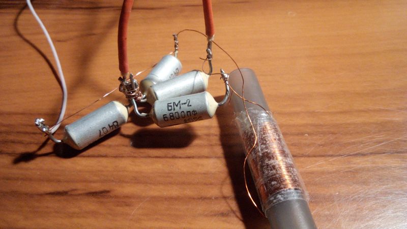

I need frequency 600 kHz. My tank circuit two 2*6800pF and 10 uH
That is like asking a VW Beatle to perform like an F1 racer. You'll need to do some research if you want the op-amp solution at 600kHz (your current op amp will even have trouble with 60kHz... or even 20kHz). I suggest a transistor solution for your Colpitts oscillator.
Ok, i had achieved working Colpitts oscillator schematic.
The frequency become much lower i want - 476 kHz.
But i still can catch it on chine receiver at MW 150-285 kHz.
