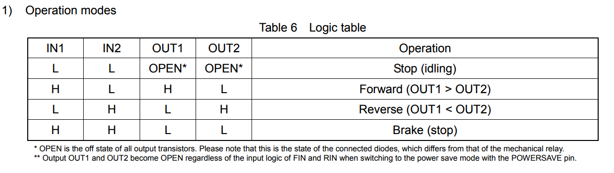

I'm not familiar with BA6285FS and was wondering if someone here is. I need to limit the current to the actuator so that it doesn't go over ~100mA and I think it can be done with BA6285FS, but it's not clear to me from the datasheet. The actuator has internal circuitry (switches) to stop the drive power, but only when it is fully extended or retracted, my concern is if it's stuck in the middle, it will most likely overheat and burn out thus why I need to limit current or some other safety measure. Will adding like a 120Ohm resistor to VM and tie it to +12rail accomplish this?

As for your actual question, I see no current mechanism inherent to the driver IC. You can make your own current limit by putting a current sense resistor in series with the motor, and reading it with a comparator and then having the comparator gate the FIN/RIN signals going to the IC.
You will also need a differential amplifier or current shunt amplifier to amplify the voltage across the resistor before feeding it into the comparator. The one you choose will be dependent on whether you choose to place the currenrt sense resistor on the high-side or low-side of the motor.
Or you can choose an IC that combines a current shunt amp and a comparator:
https://www.ti.com/amplifier-circuit/current-sense/comparator/products.html
Since your circuit is bi-directional you will have to take into account that there is both a positive and negative threshold for overcurrenet which may mean you actually need two comparators, depending on how you want to go about it.

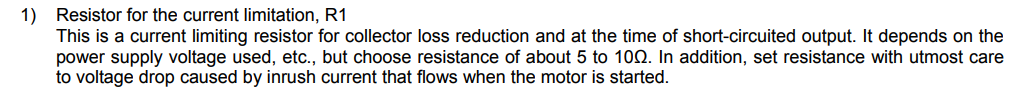

So on the BA6285FS how is the current limited on the Vm input by using a resistor? It also looks like it's dependent on Vref, not clear from datasheet.
I dont see that on the datasheet anywhere
EDIT: oh, its a mult-soucred part so there are multiple dtatsheets from different manufacturers. R1 is just a resistor in series with the motor if you look st the internal schematic.
