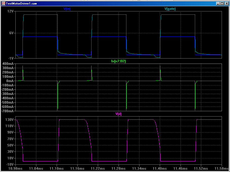

Here is a low-side IGBT gate driver that I built into my airplane mover. It uses a 1/4HP 130Vdc GearMotor. I am using a PIC to PWM it at about 10kHz to smoothly control the acceleration/deacceleration. Picture here.
The green trace is the current into the gate of the IGBT. It takes a driver with a current drive of ~1/2A to rapidly charge/discharge the IGBT gate capacitance.

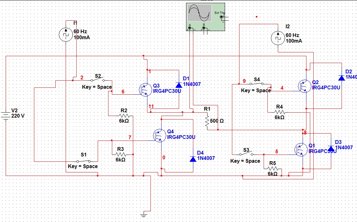

We plan to apply it to an AC Motor, is it not applicable? Another question, doesnt an IGBT acts as a switch? so when it turns on, it sort of turns into a closed switch where it will let voltage flow from collector to emitter? Thanks

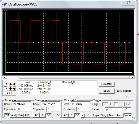

This is the circuit that we simulated, the 500ohm is like our "MOTOR" and we switch the igbt's on and off correspondingly for it to become an AC.

You were told in the first three posts in this thread that this entire enterprise is a fool's errand.
The project has become: Lets learn how to make a Variable Frequency Motor Drive controller[/I]. If I really thought I needed a VFD, I would just buy one.
