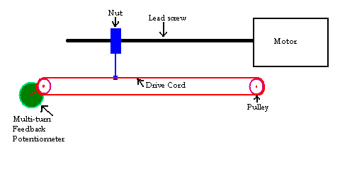

Missing the easy answer ?
A 24 inch travel would be easy if ...
The motor turns a threaded rod (a lead screw).
The lead screw has a nut on it which cannot turn so when the lead screw is rotated the nut will travel up and down the lead screw.
The nut has a 'bit of string' (drive cord) tied to it, this is looped over two pulley wheels as shown.
One of the pulley wheels is fastened to the shaft of a 10-turn potentiometer (or 5-turn or whatever).
As the motor turns,
the nut travels up or down the screw,
The drive cord is pulled one way or the other,
The potentiometer shaft rotates,
## FEEDBACK ## :!: connected to the servo positioner
Old radio tuning dial sort of thing
Controlling the beast
