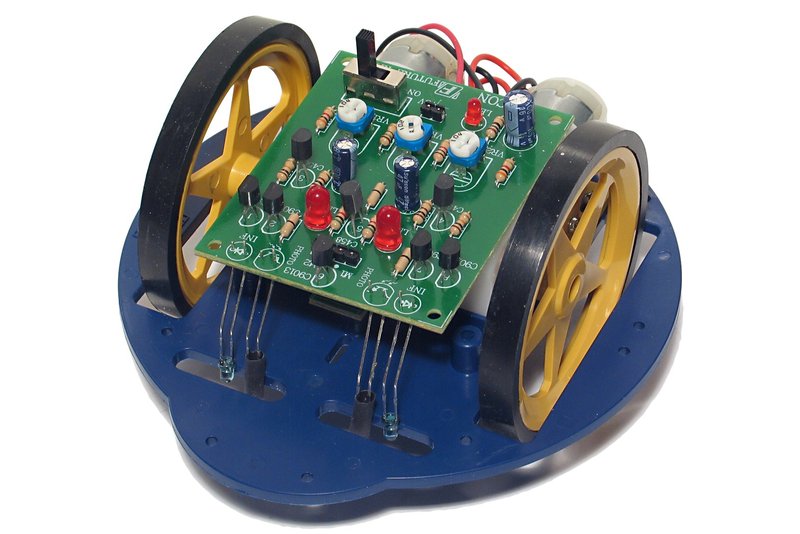

I recently bought a line following robot FK1108 made by Future Kit. See attached manual and photo. The stock circuit is works ok, but I thought about making an enhanced circuit with H-bridges and microcontroller and so on.
To make a speed controller I would need to measure the rotation speed of the DC motors. I thought about detecting the noise of the brushes, but that won't work reliably because I intend to use PWM to controll the speed.
The obvious solution would be to put photodiodes and leds at each side of the wheels and use the spokes as optical interrupters. That would probably work well, but the measurement rate would be quite low, especially at low speeds. The ideal situation would be to measure the rotation speed of the motor shafts directly. The problem with that is that the only portion of the shaft that is accessible of the motors is about 0.5 mm long at the back. That is too short to attach an optical interruptor disk. I thought about maybe using a hall-sensor to detect the changes in the magnetic field, but because it is a DC motor, the magnet field is stationary. So I don't think that would work either.

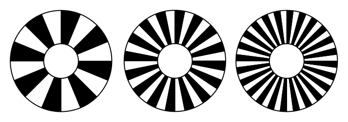

I came up with a solution that is not as good as measuring the rotational speed of the motor axises, but is probably good enough. That is to increase the amout of "spokes" on the wheel by attaching an optical disks to them (fairly obvious...). I attached some templates to this post if someone else needs them.

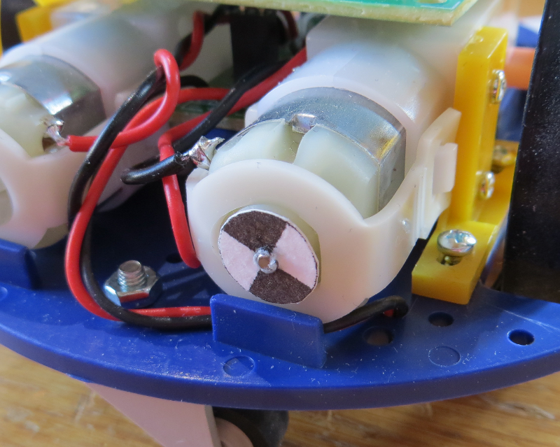

I spoke too soon. It tried attaching an optical disk to the motors' shafts, and it worked beautifully. I just had to print on a thicker paper to get enoug rigidity. Then I pushed a pin through the paper and fitted it on the 2 mm axle and applied a drop of super glue.

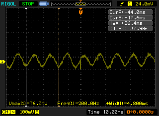

I tested it and got a rotation speed of 38 Hz, or 2300 RPM.
Any thoughts?

Your signal swing looks almost sine like, and is very small in amplitude. How have you set your photo diodes up? Got a schematic?

BTW You have measured the frequency over the period of two cycles there, so double your 38 Hz and RPM.

The signal I posted was got by connecting a phototransistor to ground through a resistor and monitoring the voltage at the resistor-transistor junction. I was just holding the setup in front of the optical disk with my hands, without any lightsource except the light comming through the windows and ceiling lights. So it is no surprise that the signal is quite bad. It was just a "proof of concept" test.
The quadrature encoders from old computer mice was a interesting idea. I could use that in some project. I'm trying to measure the speed of the motors as easily as possible. I measured the gear ratio, it was about 1:49. By using an optical disk with 24 black/white sector pairs on the wheels would yield 24 pulses per revolution. I think I can fit 3 back/white sector pairs on the motor optical disks, which would yeld 147 pulses per wheel revolution (or the double amount if both edged are counted), which is an resolution enhancement of about 6 times (or 12).
The dissection of the motor sounds interesting too. I'm afraid it is a bit too cumbersome for this project. If I fit 3 sector pairs on the disk, the resolution woud be the same.
I'm measuring the period over two cycles because the optical disk I used has two back/white sector pairs, so two cycles equals one rotation.
Makes sense - I have a habit of measuring one cycle and calculating from there. Not quite sure why but I assumed everyone else did the same :eek:
