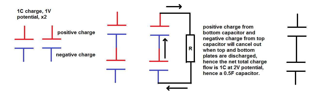

You are correct. The charge remains at 1C, but the electrical potential (i.e. the voltage) of the series stack is doubled, hence conservation of energy is conserved. if we think about the "middle" plates, the charge on them is isolated from the circuit, so any current that flows will cause the charge to cancel out internally.
Would something like this really poor MS paint diagram help?

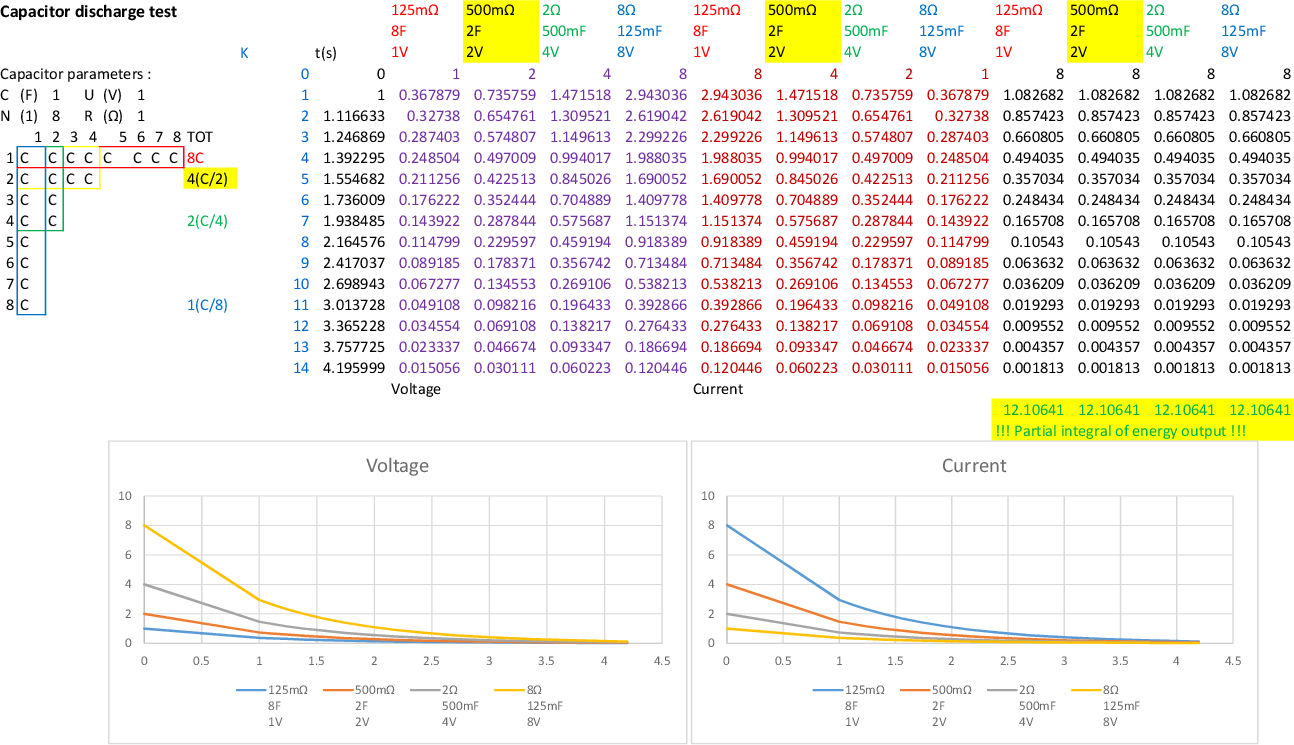

((((sh¡t&sh¡t)))) . . . so - Δq=ΔU·C , P=UI ,U=ΔA/Δq , I=Δq/Δt (Attempting the energy conservation showcase) ΔE=P·Δt = UIΔt = U(Δq/Δt)Δt = (Δq/ΔC)Δq=Δ²q/ΔC . . .
. . . 1F||1F=1/(1/1F+1/1F) =1/2·1F , incase ΔE=Const. the Δq=²√(̅C̅o̅n̅s̅t̅.̅·̅Δ̅C̅)̅'=±i√(̅C̅o̅n̅s̅t̅.̅·̅½̅)̅' :wideyed: -- but this would be valid for variable capacitor (with external force applied to pull appart the plates) not tiled/combined one . . .

there's something but i've not verified it yet . . . http://hyperphysics.phy-astr.gsu.edu/hbase/electric/capac.html#c3 . . . -- but this is not your case coz you tile pre-charged caps -- where it must be easy to show P=UI must preserve so Pdt=dtUI also e.g. E.stored=no change only the I against t graph would vary ... eEcsv-xls.png
