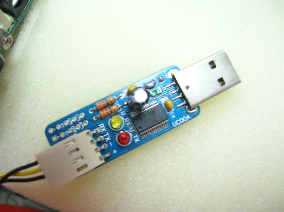

Hello all,
I've just purchased a USB->SERIAL connector but not sure how to connect it to the PIC16F877.
The connector has 4 connections, TX, RX, GND, +v.
The USB converter actually powers itself from the USB and it says on the manual that the +v pin can be also be used to power the PIC.
Tx and Rx is fine, but do I connect the +v and gnd to the pic power source too? (my pic runs from another power source without using USB power)
thanks for any kind replies.

Which one?
There are a number of modules based on the partial chip number you call out. Some are RS232, some are digital, or are you talking about a raw chip?
Only the first needs level translators. Simply tie the gnd and signal wires together, watching which is input and which is output since they can be confusing.

sorry to confuse. I actually had a complete part which built with the FTDI chip. so, I just have to attach 4 wires to the PIC using UART. I've tried Nigel's solution and worked.
I was just confused with the optional +5v supply whether should be used or not.
If took some sample code from Nigel's tutorial to test. it worked fine on transmission, but when it comes to receiving, it just doesnt work correctly.
my question is , should I set RC7 as input pin? or is it something else?

The FTDI sell different "parts", some of them are USB on one side and TTL on the other, and some are USB on one side and RS232 on another.
The output of the FTDI chip (for example FT2232 I use) is TTL so 0 - 5V, but you can find circuits that are USB to RS232 that have RS232 output levels +/- 12V IIRC (or even more)
So, can you make a picture of what you are connecting with what, or give us the link to the part number you are using as a USB to UART adapter.
If you are using something like this:
or like this:
Then you can connect it to your PIC directly (just set the jumper to 5V as your PIC is 5V and not 3V)
then again, if you are using something like this:
you cannot attach it directly to a pic because this one have RS232 level outputs (+/- 12V)
on the other hand, this one:
can be connected to both directly PIC (via CBUS connector on the side) or to RS232 device (via DB9 connector on the back)
so, which one is it ? they are all FTDI evaluation kit's, and that is just a small section of them as they offer much more

one more thing, RX pin on the pic should be INPUT and TX pin on the pic should be OUTPUT, your code set them both to output, how can you receive data on output pin ?
Ok, problem solved.
it seems that i'm having a trouble of FERR due to I input too fast in between 'call Long_Delay'. After I put a debug code to check for FERR and OERR, it finally shows the cause. So, hardware wise is not an issue.
now I can see the correct response from my hyperterminal with both receiving and transmitting.
