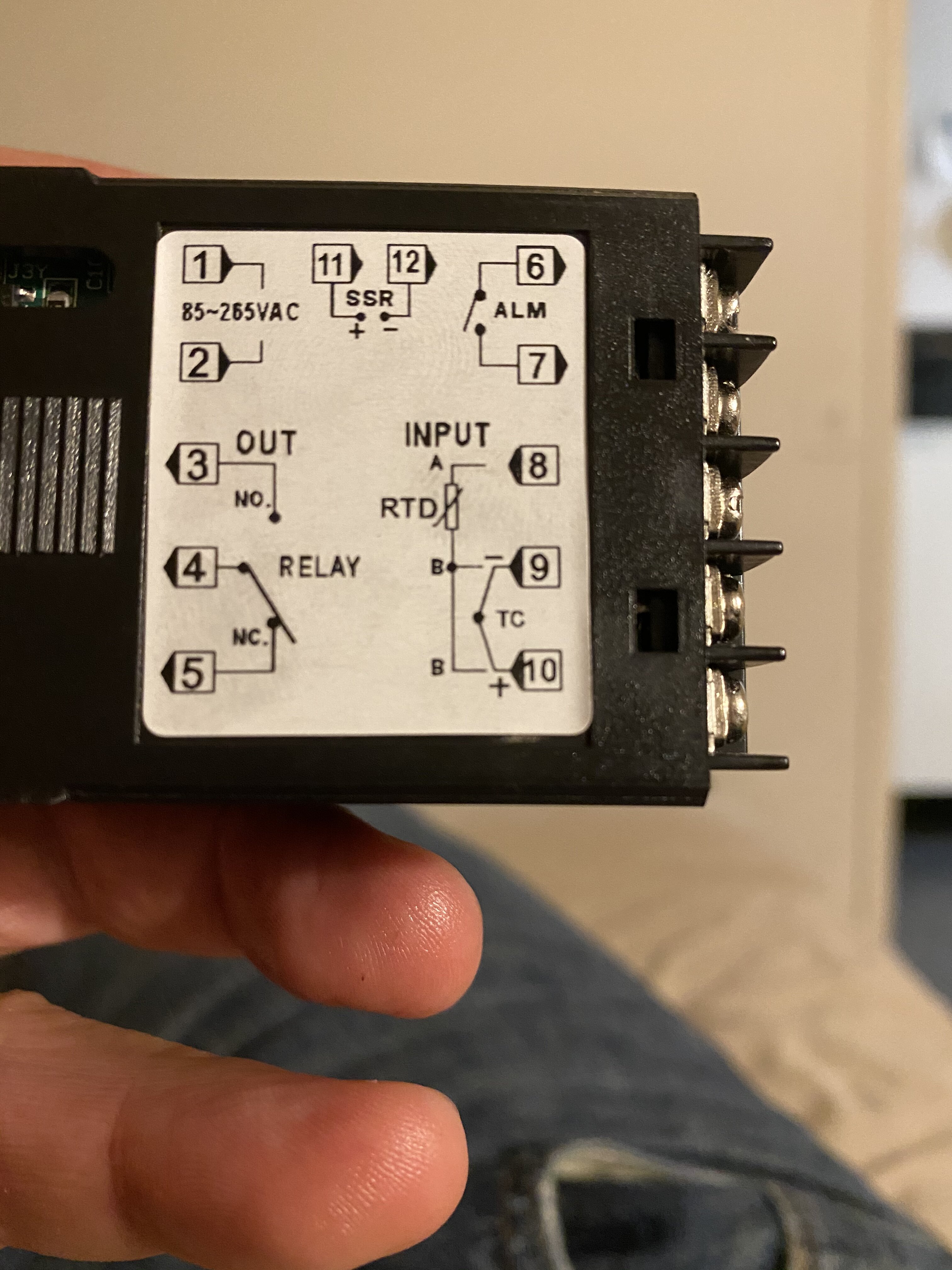

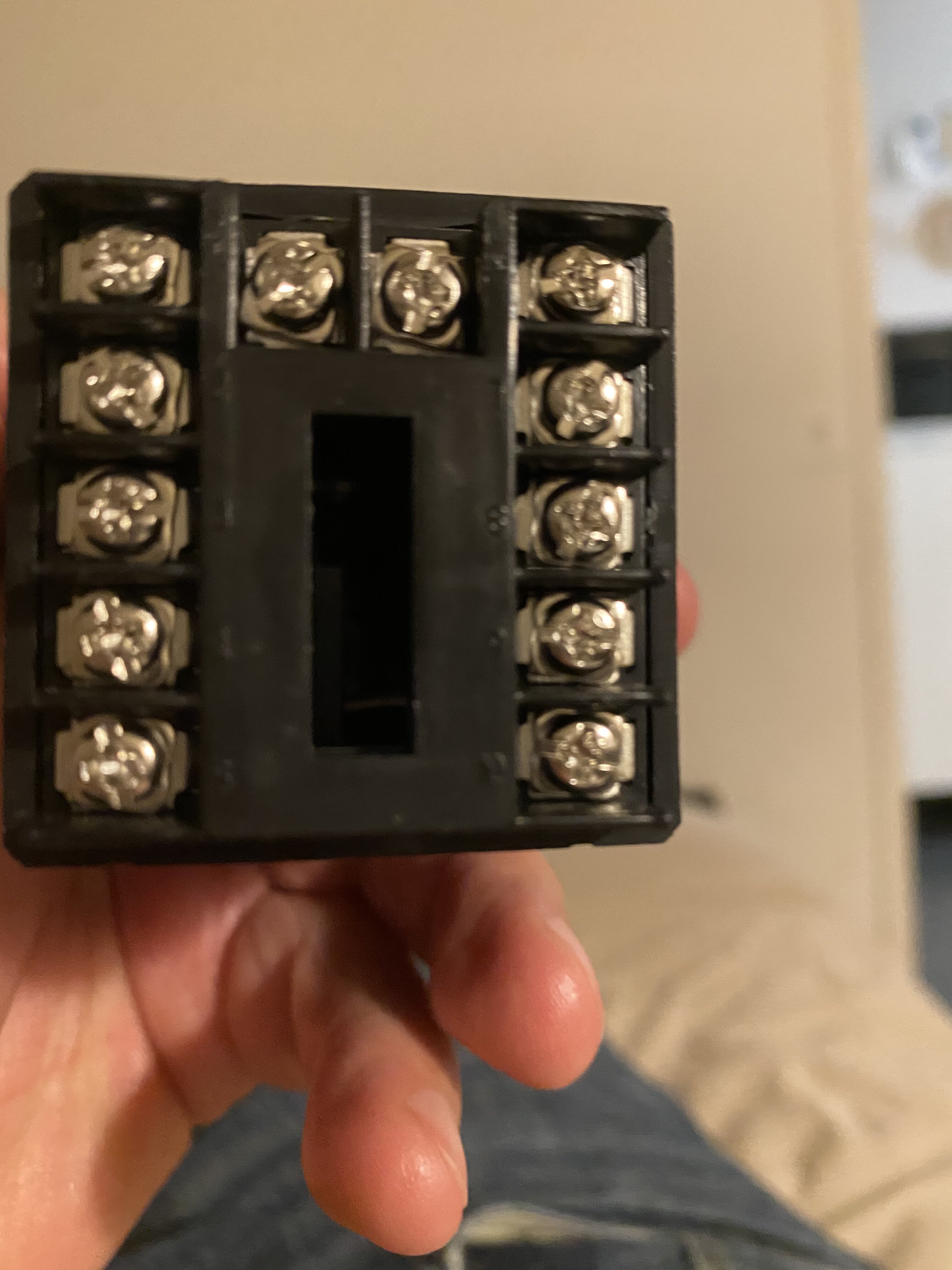

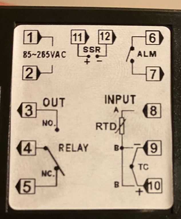

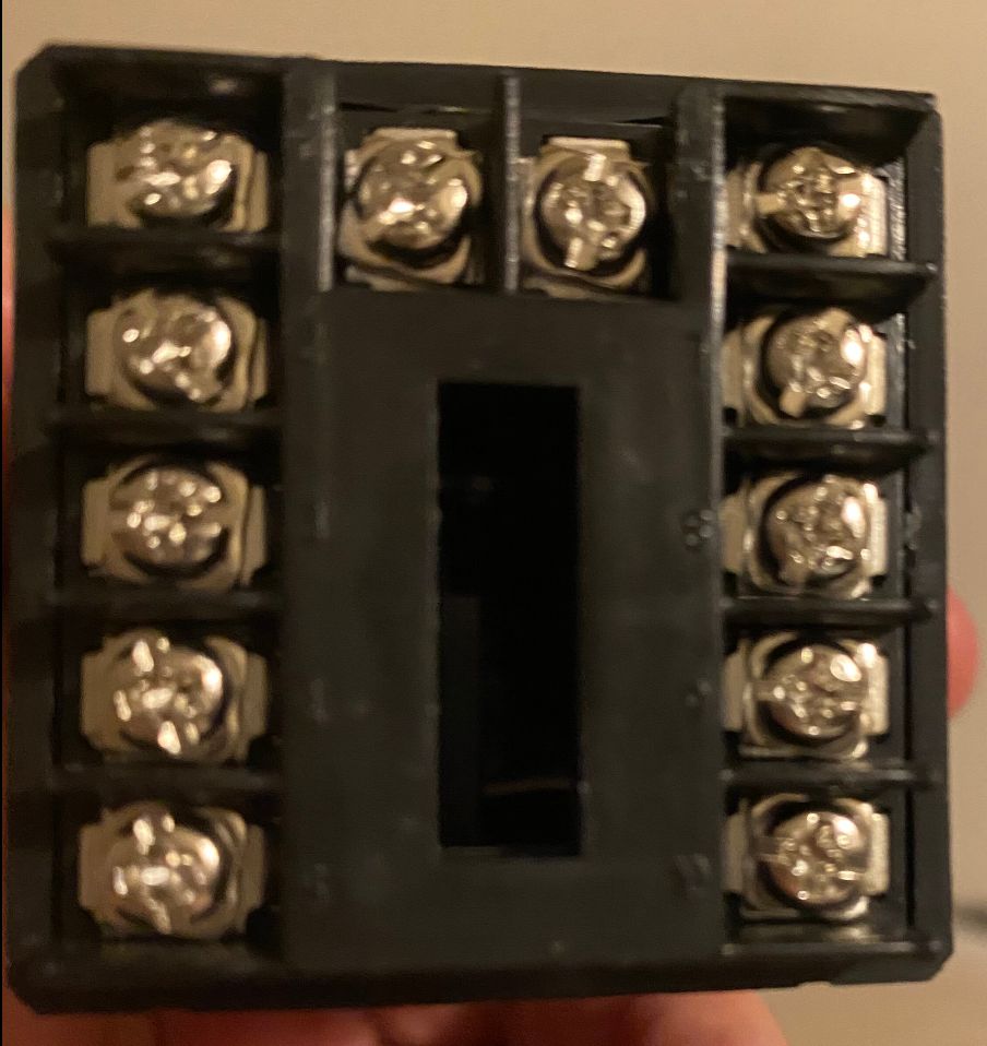

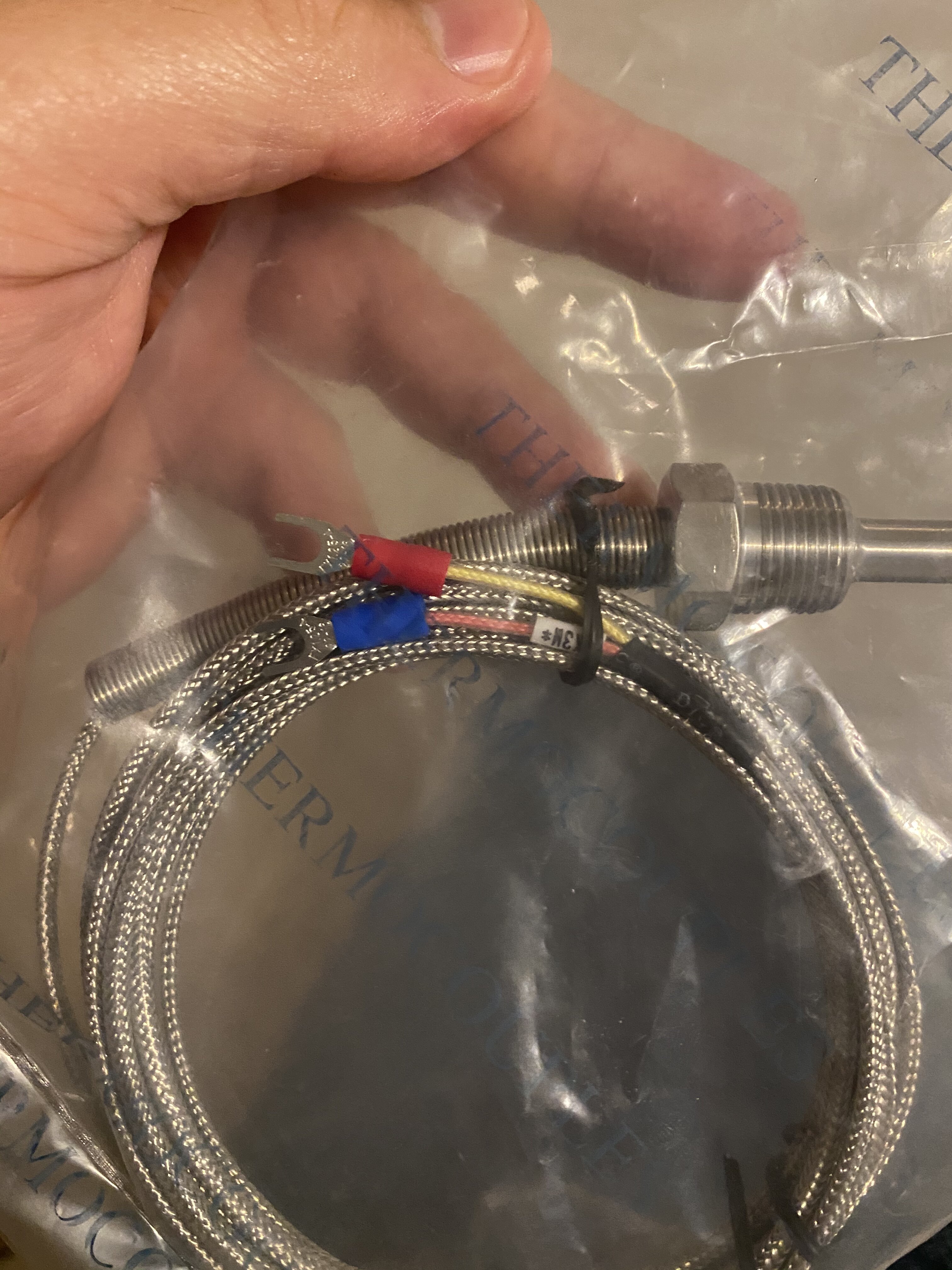

Hey guys and girls - I recently bought a thermocouple and a temperature display from China. I am planning to use this in my smelting forge - now I’m stuck looking at a diagram which means as much to me as a Sunday school hat to a pig...
would anyone be able to help to explain where do I connect the coupler and how to connect the power to the temperature controller?

Try this:
Connect the mains power supply to terminals 1 and 2
Connect the thermocouple to terminals 9 and 10.
Best guess, connect the red end to the TC to terminal 10 and the blue end to terminal 9.
Without any details of your power controller I hesitate to suggest how to connect to it.
To check that the connections are ok so far, apply power and look at the displayed temperature, it should show around ambient temperature.

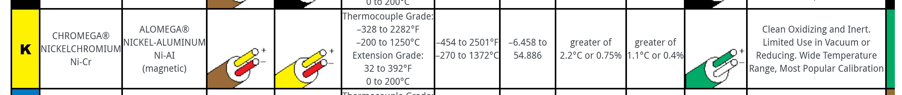

The color code for the thermocouple. Contrary to normal convention, the red conductor is negative and the yellow positive.
Per the label, the negative conductor of the thermocouple goes to terminal 9, the positive to 10, so red to 9, yellow to 10.
The terminal numbers are marked on the back - just match them to the label.
Thermocouples have types and colors. e.g. J,K, R, S, T where K is the most common. The outer jacket is yellow for K.

K or Chromel-Alumel. Red is the negative lead. I forget the other color. Lots of info on www.omega.com Red is universally negative.
