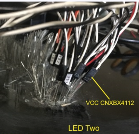

Using the VCC CNXBX4112 it is often difficult to get the
LED leads to fit down into the header. See attached photo
marked 'LED One'.
[IMG]
In that photo the header marked 2.2.2 sits
down properly on the LED leads. The other two headers on the
right, like many others, even after fitting and refitting for
five or ten minutes will not go down onto the LED leads.
When the leads won't go all the way down on the LED lead,
if even touched slightly, will some times disconnect.

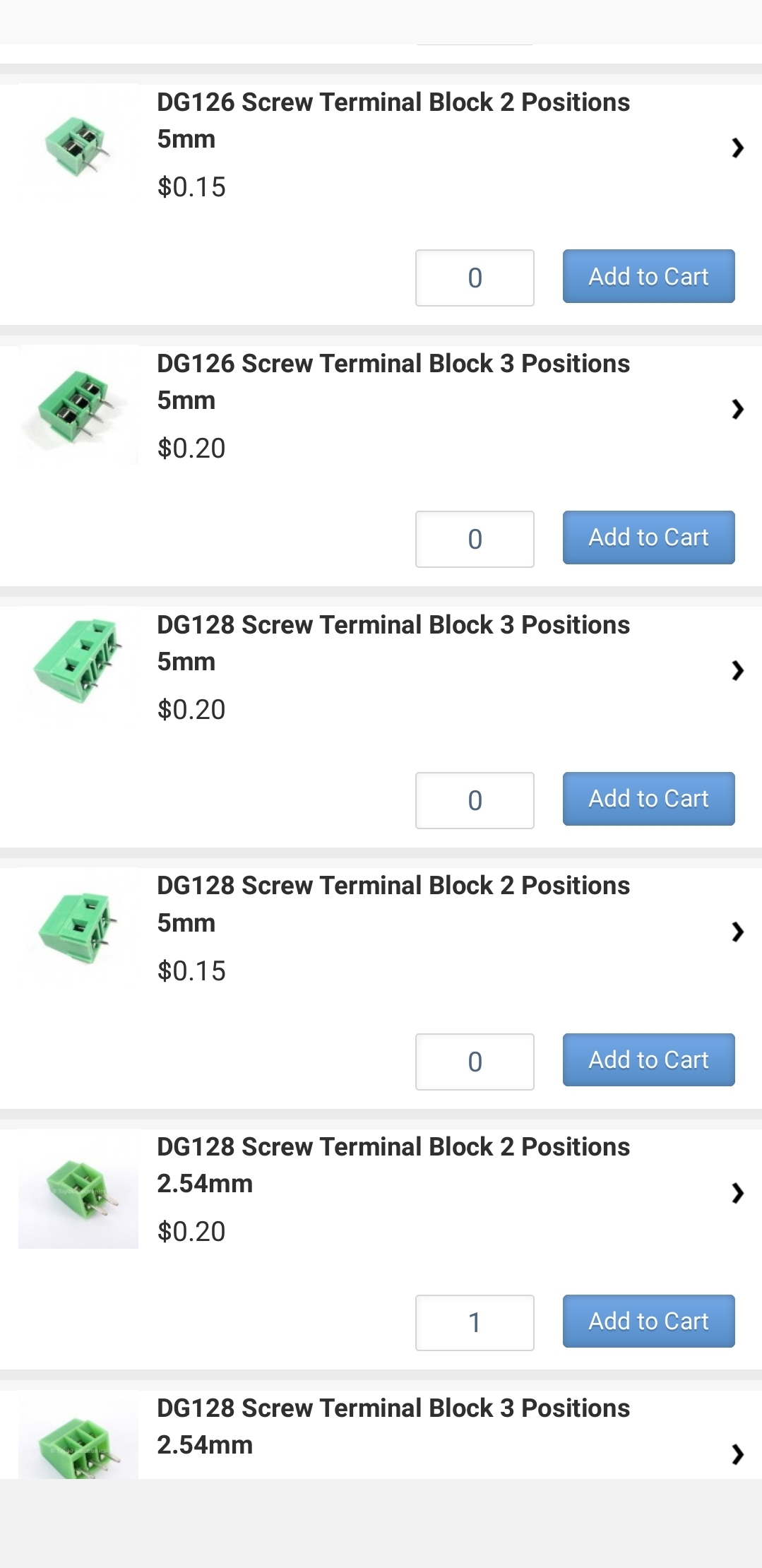

Let me introduce you to Tayda Electronics. Paying over $6 for terminal blocks is insane. A variety of types come in 2 terminal and 3 terminal sections that interlock together. You can build a block whatever length you need by adding sections together.
Tayda is in Thailand, with a US warehouse. Everything I have purchased from them has been good quality.

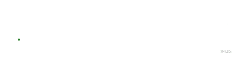

The display is not a seven segment display but rather a simple linear display of LEDs
This is partial animation: (wont let me add anim gif, have attached )
The overall display is about 3" tall and 16 " wide:
