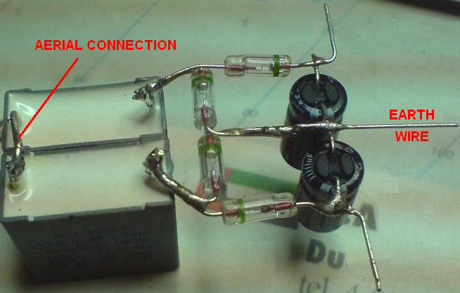

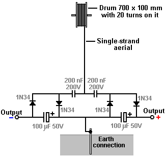

I'm trying to build the circuit attached below. Where is the best place to get these. I've been to Maplin's and managed to get the 100µF 50v capacitors, but not the others or the diodes. I've also had a look on RS-online, but find it confusing there. Needless to say, I'm new at this
Diode: 1N34 or 1N34a Germanium
Capacitor: 200 nF 200v Ceramic disc types

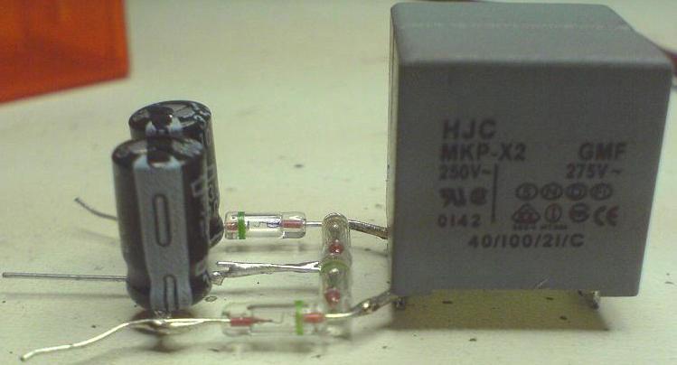

from some old stuff, the germanium diodes you can find them in the tuner in old CRT TV's, the 200nF 200V why a Disc type ?
you can use some block type, in the images the 200nF are block type

Hi TotalMadness,
Diode: 1N34 or 1N34a Germanium:
1)Manufacturer: MICROSEMI; Manufacturer Part Number: 1N34A;CASE:DO-7;
Reverse Voltage: 65V;Forward Current:50mA;Operating Temperature Range:-55°C to +75°C;
2) Manufacturer: NTE;Manufacturer Part Number:1N34A;CASE:DO-7;
Reverse Voltage: 75V;Forward Current:50mA;Operating Temperature Range:-55°C to +75°C;
3) Manufacturer: Central Semiconductor;Manufacturer Part Number:1N34A;CASE:DO-7;
which one is your wanted?
Capacitor: 200 nF 200v Ceramic disc types:
NO 200 nF 200v Ceramic disc types in market; I think this is what you wanted, here it is:
Through Hole;Manufacturer:Kemet;Manufacturer Part Number:05HV22B204KM;CASE:0.275 in
0.2µF(200nF) 500V exactitude: 10%;temperature coefficient:X7R
