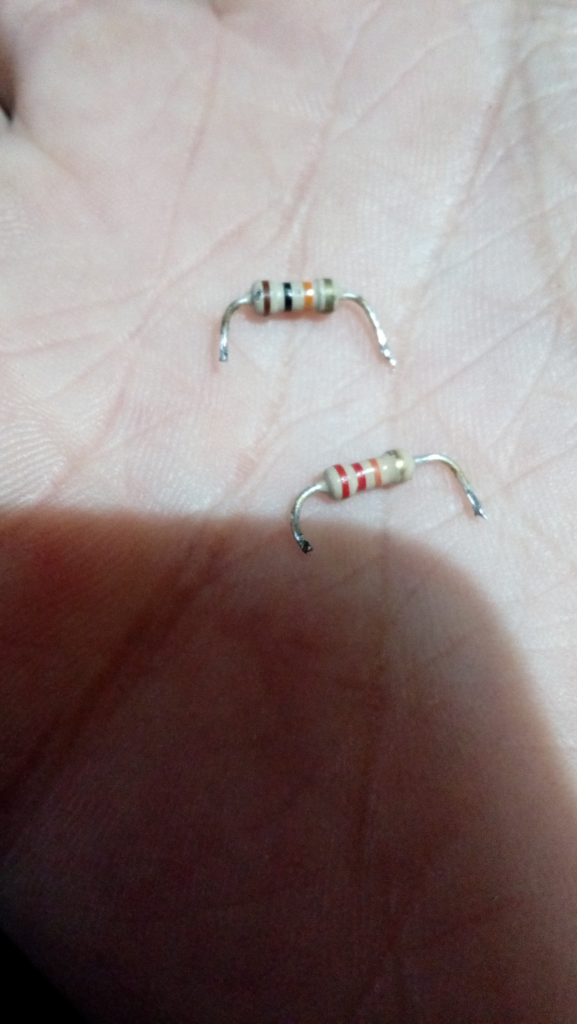

You need a load - if it's not plugged into a working computer you need some other kind of load, the classic method is BIG wirewound resistors. Assuming it regulates from the 5V line, a 2.5 ohm 10W (or higher) resistor should do and draw 2A.
Put a "sandbar" 10w 10 ohm resistor across the 5v rail. It will draw 0.5A and allow the regulator to stabilize the voltage.
I think one of those 2 resistors I show would be valid, right?
Brown, Black, Orange, Gold = 10k Ohm
Red, red, orange, gold = 22k Ohm
Those are probably 1/4W
You need something like this:
Or this:
Ok, I don't have this kind of resistors, I will get a couple of them for testing asap.
