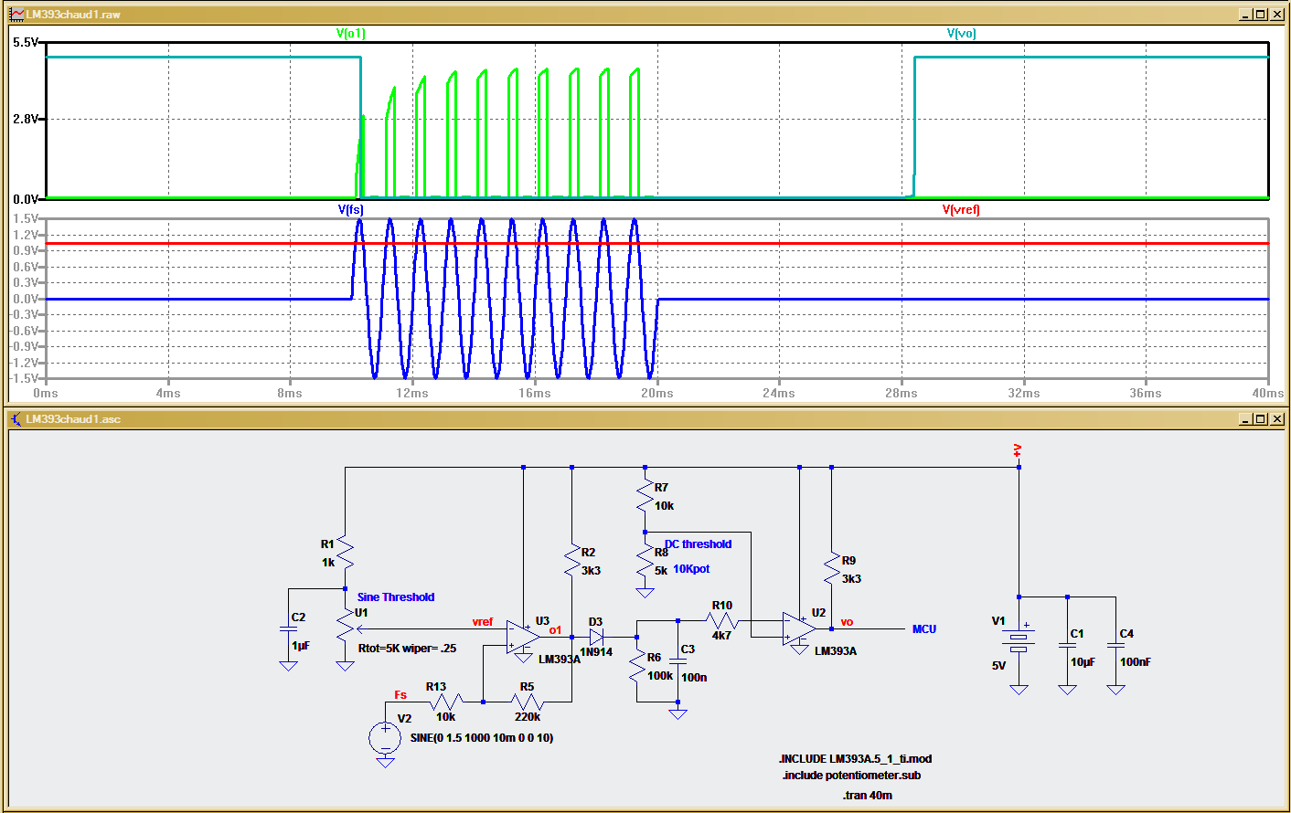

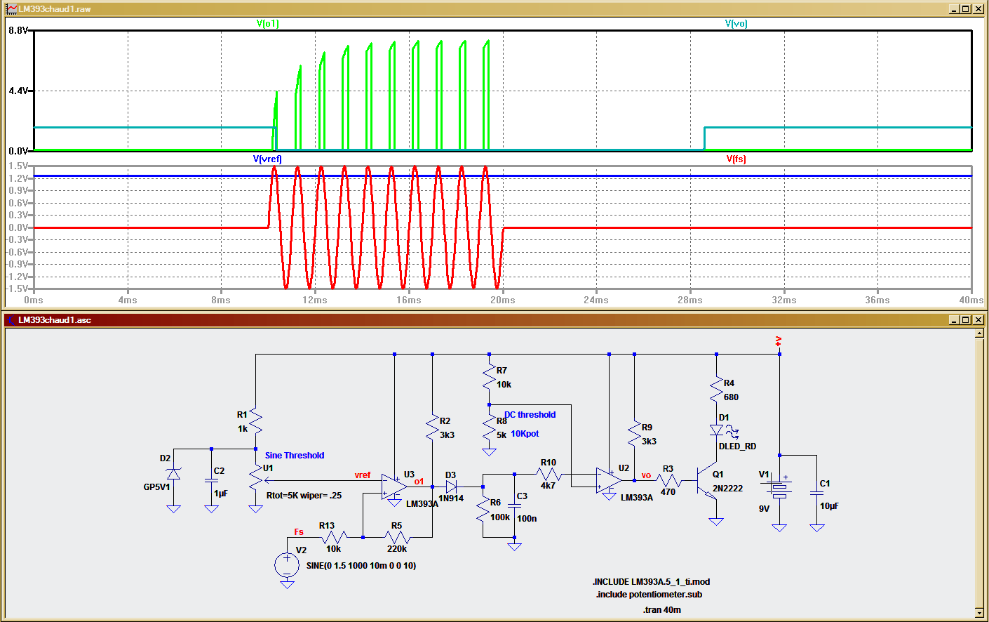

I will post a circuit for a LM393 within 24 hrs.
EDIT:
This circuit uses both halves of the LM393 dual comparator.
The 1st Stage is a sine wave comparator, which give a pulse output when the Sine signal amplitude exceeds the Sine Threshold.
The 2nd Stage rectifies the pulses into a DC signal, the DC threshold signal level can be set.
When the DC signal is LESS than the DC threshold the output of the 2nd Stage goes high.
When the DC signal is higher the output is low.
A high drives a transistor output stage.
For demo the transistor drives an LED, the led could be replaced with a small DC tone buzzer, the buzzer would sound when the Sine signal is LESS than the Sine threshold.
The two control pots enable a wide range of threshold settings.
Ask if you need more help.

Hey, thank you very much, but i have some questions about it, FS or V2 = my input signal from bobine right? Where i get the final signal to send to micrprocessor? edit: im studying it now, thanks for circuit!
Fs is the input signal.
The output signal to the micro is from 'vo'...
Note:
this circuit uses a 5V supply which makes the Vout [MCU] compatible 0V/+5V
