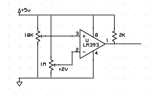

To keep things simple, I've reduced the circuit to not include hysteresis. I can't seem to find how to attach a schematic (sorry!), but the circuit is literally the LM393, +5V supply to the comparator and two pots, one 1Mohm for the -ve reference input and a 10K for the +ve input, all connected to ground. The output of the comparator has a 2K pull-up resistor. I've tabulated the results with varying reference voltages and corresponding input voltages that start to switch the comparator output to 'high' ( more or less +5V):

The point at which the input starts to switch the output seems to be proportional to the reference voltage, increasing as the reference voltage increases. The circuit is practically the same as the many examples on the internet but it just doesn't seem to behave in the way that they say, i.e. to switch around the reference voltage! The LM393 datasheet makes reference to common mode voltage but the LM311 datasheet does not. Even so I don't see how this explains the results in the lower end ( <=+2V reference ) of the tabulated results.

Use a pot with a much lower value instead of 1M that is loaded down (actually it is loaded up) by the input bias current, and loaded down by your voltmeter.
Try to post the schematic. Click on "Manage Attachments" and upload the file.
Is there a feed-back resistor? and a load resistor?
Hi Eng1, I've attached a schematic. The 1M pot has been replaced with a 1K pot as suggested by others, but I still get the same results. I've replaced the 393 with another in case it's faulty in some way, but again no joy.. :confused:

Add a 100uF supply bypass capacitor across the supply.
