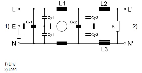

Hello,
In the attached AC filter we can see that L1 is a common mode choke.
We are trying to reduce the component count of this filter. Do you agree that we can get away with omitting the Cy1 capacitors , but that we must keep the Cy2 capacitors?
In fact, why would the Cy1 capacitors be needed at all?.....i mean, any noise that has escaped out out to earth, would always want to take the least resistance path, and that would definitely be through the Cy2 capacitors….because then the noise would be going back through the common mode choke and thus would not see the high common mode impedance of the common mode choke.
So why are the Cy1 capacitors included? If anything the Cy1 capacitors should just be used as extra capacitors at the same position as the Cy2 capacitors. Do you agree?
As you know, Common mode noise returns to earth. (as you know, it obviously came in to the product via live or neutral)
If noise returns via the mains live or neutral than its not common mode noise. Any noise going through any of the y capacitors will end up returning via live or neutral, and so it will not be common mode noise.
True common mode noise, which returns to earth does not get “LC filtered”. Common mode noise couples out of the product, and then returns to earth, probably outside the product….it certainly does not traverse the y capacitors, because if it did, then it would be going back in to live or neutral, which means it would not be common mode noise any more.
Common mode noise is reduced by having a common mode choke…..the common mode choke “forces” noise which has coupled out of the product to come back into the live or neutral wires, via the common mode chokes other half……so it makes the noise into differential noise, which gets acted on by the differential filter.
So, Y capacitors do not filter common mode noise……Y capacitors actually transport noise back into the mains live or neutral from earth…..making it “differential mode noise”.
This is why I question why Cy1 (in schematic in post #5) is needed. Any noise which has coupled out of the product that will return back into live or neutral would choose the Cy2 route…because that takes it back through the other half of the common mode choke…where it sees the inductance of the common mode choke cancelled out…..if the noise were to return via Cy1, then it would miss out the other half of the common mode choke, and it would see a very high inductance, so therefore it would certainly not take that route…electricity generally takes the lowest impedance route, which in this case means returning back to mains via Cy2 and the other half of the common mode choke.
So why is Cy1 needed?

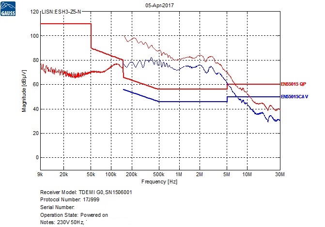

Continuing from my above comments on common mode noise……given the attached EMC scan result of a product which contains no AC mains filter, it is actually impossible to exactly calculate what combination of differential and common mode filtering will be needed to attenuate this noise down to below the pass/fail threshold.
The product of this scan is actually a 150W non-SMPS based lighting product……..but it does contain a 0.5W SMPS for bias power.
The only way you can approach this AC filter design (for the attached EMC scan result), is to make a Differential mode LC filter which attenuates by 35dB at 150kHz (that brings it below the line). You then have to more-or-less guess a common mode choke value, and guess accompanying Y capacitor values, and hope that that will convert most of the noise of the graph to differential mode noise….for which you can design a filter with known attenuation.
The problem with these conducted EMC scan result graphs, is that there is no way of knowing exactly how much of the noise shown is common mode and how much is differential mode.
It is thus impossible to exactly calculate filter components…you must simply design by emperical means (try it and see).
I have it on good authority that when returning to work this week, I will be sacked with immediate effect, due to my having first designed a pure diff mode only filter which attenuated down by 35dB at 150kHz. (but this did not solve it thereby I am due the sacking) The reason I did this initial pure diff mode design was because there is really not that much room for a common mode choke, so I needed to see how a pure diff mode only filter would perform. –Turns out that it doesn’t really attenuate much of what you see at all…which tells that most of the noise is actually common mode noise. If I was not going to be sacked, then I would put together a common mode/Diff Mode filter and try that out. However, the sack beckons, and I will be gone. Anyone fancy a job?
Do we all at least confess that it is not possible to actually calculate EMC filter component values for the above conducted EMC scan? (in post #7), ....since it contains a mixture of common mode and differential mode noise in unknown proportions.
