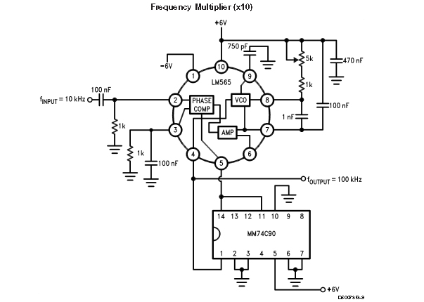

1.can somebody tell y common emitter connection is more popular than d other two... and y is d output taken at collector..
2.pls xplain y bjt is called a current controlled device?
3.can somebody help me with design of freq multiplier using 566. phase locked loop... give some idea

3. A VFO creates a high frequency signal. A counter is used to divide the high frequency down to a lower frequency. That lower frequency is compared to a reference frequency, and the VFO frequency is adjusted up or down as a result of the comparison. That's it in a nutshell. The VFO frequency is a multiple of the reference frequency.
Russlk said:
The divide by 5 output is connected to the phase comparator, which is incorrect. The divide by 10 output is pin 12.
This is interesting so I looked up the LM565C from my 1980 NS Linear Application databook. Guess what? The PLL phase comparator pin 5 did get its signal from counter output pin 12(divide by ten).
So there is a delibrate change on the circuit configuration. But why?
The main difference of the present circuit wrt the 1980's circuit is that of the power supply arrangement. A single +12V supply was used back then for the PLL while dual supplies(+/-6V) for the present circuit. The decade counter supply remains unipolar(+6V or +5V) in both circuits.
Therefore the new arrangement could have something to do with the +/- swinging nature of the 10KHz frequency input(wrt gnd) but the unipolar output of the counter.
