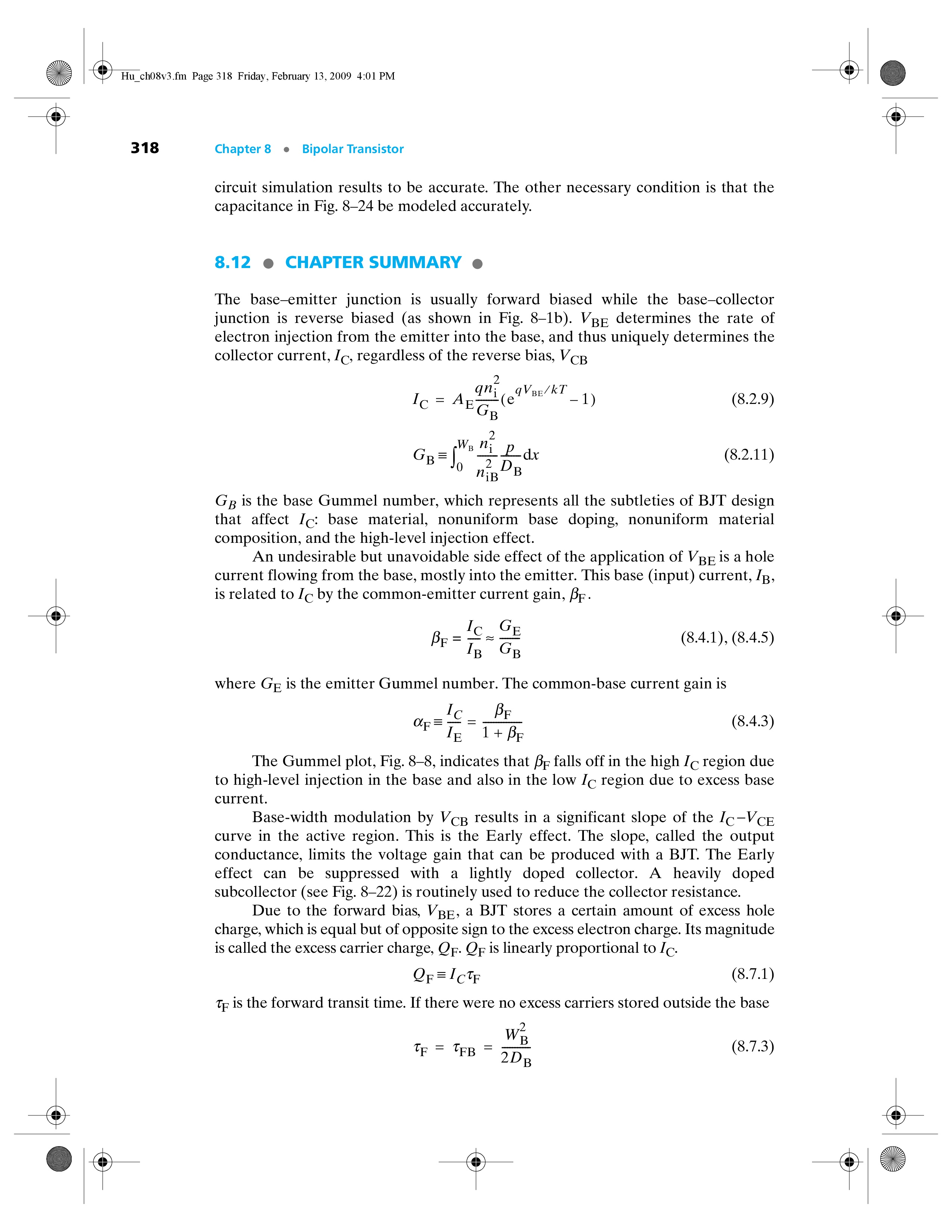

I just have read your contribution and like to add a comment ?
I have some doubts if beta really is "the most important factor" and that beta would be "the gain of the transistor" and that this is the "reason for having a transistor".
Regarding the gain properties I think the transconductance g=delta_Ic/delta_Vbe is the relevant parameter (remember the basic expression gain=g*Rc).
Regarding the role of the base current Ib and the factor beta I like to direct your attention to the enclosed document from Berkeley University (summary of chapter 8).
It would be interesting to hear what you think about the statements in this text regarding the importance of Ib and beta.

Quote:"To suggest that the β of a transistor can be canceled out or ignored in such an equation is quite preposterous"
May I point to the fact that in post#16 I have designed a circuit in common emitter configuration - including the bias resistors.
And in this calculation, I intentionally have ignored the so-called current gain value.
For my opinion, the results (deviation between desired and actual collector current) are not too bad (4...8% deviation).
In this context I remind you on the principle and the consequences of negative feedback: To reduce the influence of the active parameters and its uncertainties.

Now there is a dispute regarding the "importance" of Ib/beta. The Berkely reference is misleading and sophomoric. This book excerpt treats base current as a mere residue from "applying Vbe". Nobody applied Vbe to a bjt, it would be destroyed. Vbe is the energy per unit charge lost crossing the junction, Vbe does not drive anything. Ib is necessary to initiate bjt action as is Ie.
Also, what is Ib good for? First we must learn what Ib consists of, how it is formed. Ib has 3 important components, transport, injection, and displacement. The Berkley reference correctly identifies the injection component as consisting of holes from base to emitter when b-e junction influenced by external E field source. Buit they call this Ib component an annoyance. My beef is that Vbe is every bit as much an annoyance as is Ib. An ideal p-n junction when forward biased exhibits a non-zero current with zero voltage drop.
The b-e junction of a bjt is a forward biased p-n jcn, so how can Ib be an annoyance. A perfect p-n junction would result in Ib and Ie non-zero with zero Vbe. Treating Vbe as the driver, and Ib as an undesirable "side effect" is pure nonsense. Superbeta or supergain bjt parts have been around for decades, i.e. beta values around 5,000 or so. How is it done? The base region is doped with a very sparse density of acceptor ions during fabrication. By injecting dense donor population into emitter, and sparse acceptor population into base, low Ib is achieved. So we have had the ability to reduce Ib to a fraction on the order Ie/5000. Why then, do we intentionally produce bjt parts with beta 100-500? Ib is intentionally allowed to be 10 to 100 times greater than what we can achieve if we minimize it.
The answer is that base region hole density is what prevents collector base punch through and leakage current. Early Ge devices had atrocious c-b leakage esp at high temp. Ge devices were rated no more than 100 deg C junction temp. Designers had to keep in mind the high leakage. Also, punch-through is catastrophic. If one is amplifying a signal or switching power loads, when the device is intended to be off, the c-b junction must block the Vcb w/ minimal leakage current. Punch through results in the load being placed across Vcc w/ no control. Usually this is a disaster.
So injecting way more acceptors into the base, resulting in more Ib than otherwise would exist, is not an annoying side effect at all. High voltage bjt parts, like MPSA42 at 300 volts Vce, require wide base region heavily doped with acceptor ions. A 100V part requires moderate base doping, while a 20V part uses light base doping. Superbeta parts have a Vce breakdowm of 4-5 volts. The leakage is so high that servo circuits are employed to force Vcb to near zero. These are used in op amp inputs.
Ib is not an annoyance or side effect at all. Having higher than minimum acceptor doping in the base improves the bjt leakage current, Vce break down voltage capability. In addition to providing these needed features, an emitter follower benefits from Ib another way. In an EF, the load is connected to the emitter, whose current Ie is the sum of Ic and Ib. The source driving the base must output Ib, so it is desirable that Ib be as small as can be to not load that source. But the Ib value does power the load. Ib here is not wasted, it does useful work. For common base and common emitter, high Ib/low beta provides high Vce and low leakage assuring against c-b punch through.
Beta and Ib are very important, it just happens that beta is hard to control. So we employ clever methods to neutralize effects of beta variation like emitter degen and/or global NF. I will wxpound if needed. To sum it up, those who claim that beta/Ib are mere annoyances, or residues, are low information light weight hackers who have no understanding of semicon physics. We have bjt parts w/ beta=5,000. If Ib is useless undesirable side-effect, why does the semicon OEM make parts w/ beta=50, 100, 250, etc. when they already know how to get beta=5,000. If Ib is useless every bjt would be designed as superbeta.
Reducing Ib incurs other performance tradeoffs that are downright ugly. BR.

To me, more important is that, for my opinion, you didn`t touch at all the main question „Vbe vs. Ib control“. And I still think it is worth to be discussed.
It is neither my intention nor my job to defend the Berkeley text (although I think you are a bit too harsh using expressions like “pure nonsense“ or “low information light weight hackers„).
However - as far as I`ve understood the background of the Berkeley text - I think the main objective was the question „Vbe vs. Ib control“.
And, in this context, I think that it is not „pure nonsense“ to state that the base current Ib is „an undesirable but unavoidable sideeffect of the application of VBE“.
Note: This statement directly follows the claim that Vbe „uniquely determines the collector current“.
Therefore, I understand the term „unavoidable“ to mean: With respect to other performance parameters.
I think, in your contribution you have provided a very good explanation why we have BJT`s with moderate beta values (rather than super-beta-transistors).
With other words: You have shown why it is desirable to have a BJT technology that allows a certain amount of base current.
And for my understanding this is nothing else than a demonstration of a general principle in electronics we have to live with:
Every design is a trade-off between conflicting requirements. Improvement on one side of the device or circuit is paid for with a worsening of some other parameters.
Thus, I think there are good reasons (leakage, breakdown - as explained by you) to have a design that causes/allows a certain amount of base current Ib - but the current itself is not the final goal.
Am I wrong? Do you know what I mean ?
To sum it up: I agree with you that there are good reasons to have BJT`s with moderate beta values (although super-beta designs are possible).
However, does this mean that the BJT is current-controlled? I don`t think so.
