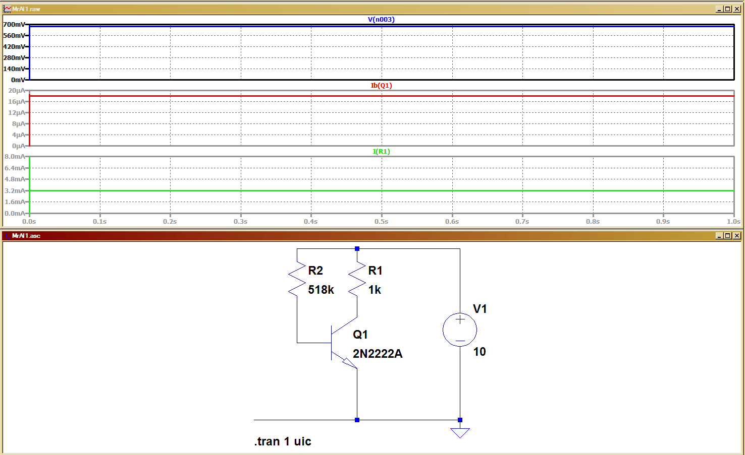

hi wiz,
Just for reference is MrAl's original circuit running in LTSpice.
Its not a serious circuit design, its only to demonstrate a problem.

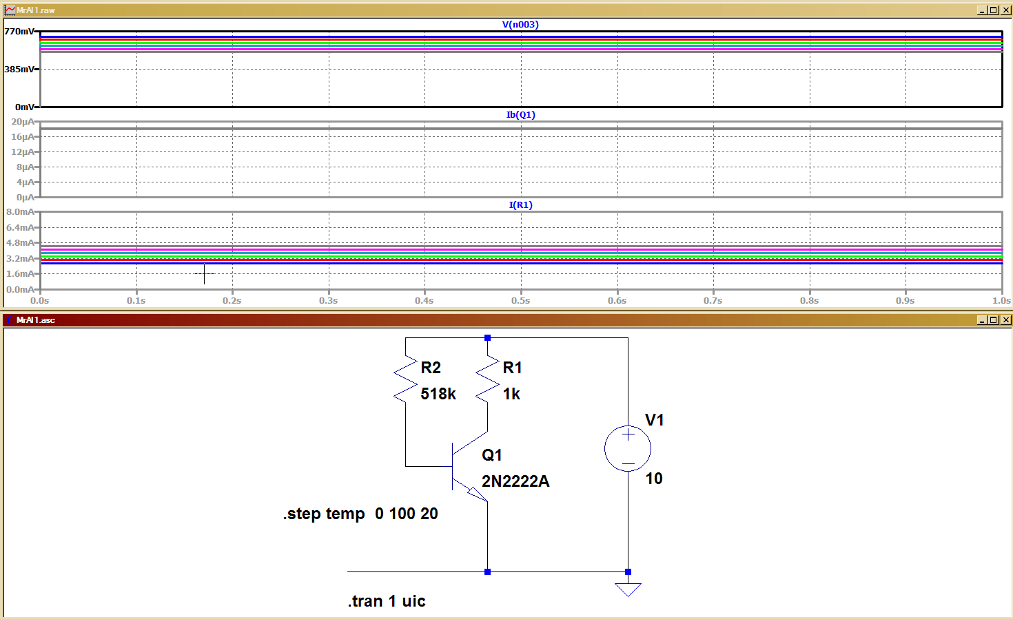

Image03 shows the effect of temperature from 0C thru 100C

hi wiz,
E.
