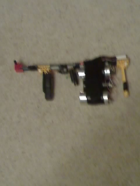

I have been overloading the little FET, SO this time I worked on it and I built TEH BEAST!
I am going to improve the coil on it :)
C1
Power: 30 Joules (going to improve it soon)
Voltage: 150VDC
I still can't get the darn thing to fire! Is 30 Joules enough Power?

Trying to help you here, but it is unclear to me at what stage you are. That is, what is working and what is not? Please correct any of the following assumptions that are wrong.
As we left the story on the previous page, you had obtained a flash unit from a disposable camera, removed the PCB and determined that you could get the capacitor to charge to 250 V in 2 sec. Then, you gave the part number for a transistor on that board (?) and later a link to a datasheet for it. The transistor appears to be a medium power NPN with a max collector current of 5A and hfe of 350. Somehow, the discussion then switched to MOSFETS and now FETs.
Are you calling that transistor a FET? Have you substituted a FET into the circuit and got it to run? What sort of voltage are you seeing and what size capacitor are you using?
Last, when you say that you cannot get it to "fire," do you mean that you cannot get the capacitor to discharge or that you can't get your coil gun to shoot? How are you trying to discharge the capacitor and do you know that your coil gun circuit would work even if given enough power?

I can get the Cap's Charged up to 200V (2160uf) and the circuit waiting to fire the coil, except the coil won't launch the Copper BB. Everything works fine but that. I have built it correctly, but I still don't think the Coil is Correct for some reason. How many ft roughly do you think that I will need of winding? I have probably been using around 20feet of copper wire.
What are you using to switch the capacitor to the coil or switch the coil to the capacitor ground (those are equivalent actions)?
I have never built a coil gun like yours. Presumably you are following an example. What does that example use for length of wire and AWG? Do you have a link to that source? Can you feel any magnetic field at all (using a piece of steel) in the coil when it fires?
John
A copper BB is not magnetic. If it is steel with a copper plating then it is magnetic and should work in a coil gun.
God I am so stupid! I would keep telling myself to use a ferromagnetic projectile, when a Copper BB isnt! Thank you so much audioguru, I will try a bolt when I get home (especially with my 50ft Coil :D)
JP, I have seen a few coilgun's using a camera flash board, but I have been going solo for a while. I have found out my problem, and it should work now :)
I was using 22 AWG enamel magnet wire.
Thanks I got it working. With 40.5 Joules, I got a inch long screw to shoot across my basement (about 20 feet very roughly). I then tried to push the circuit to 250V, but then a capacitor exploded, so it no longer works :D
