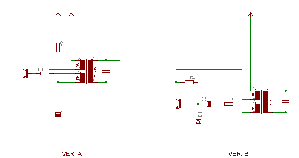

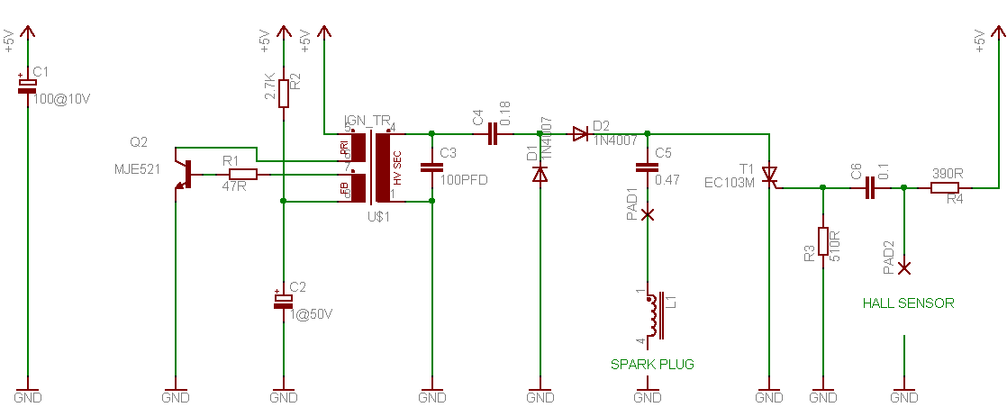

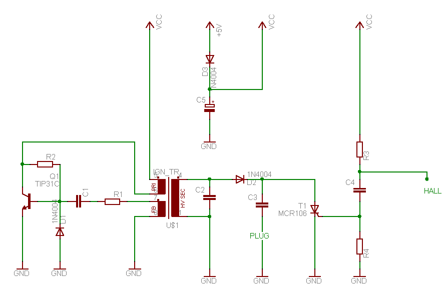

Here are some schematics for different ignitions. One includes a voltage doubler (Chinese); one is an American version without the doubler; and the last is a comparison of the oscillator side of the circuit. The circuits are all pretty similar. One difference between these circuits and the one I linked you to is the use of NPN instead of PNP oscillator transistors. Of course, you can use whatever you want ot rectify the AC and charge the capacitors. John
Edit: The names didn't come through. The Chinese ignition is the center image.

Isn't that circuit essentially the same as the American CDI design posted above (ignore the SCR firing mechanism)? From what I have seen, they are all about the same with a single transistor oscillator. Differences are mainly on whether to use NPN or PNP.
For the transformer, you can make it yourself (see: prior link), try to use a CCFL transformar (main drawback is low current capacity), scavage one from a CDI, or buy from CH Ignition (https://www.ch-ignitions.com/#cat). For just the transformer, you need to call CH. CH also has complete HV boards with transformer but minus the ignition coil for $30 (item #68). Some people use the 3055, TIP31, or MJE521 or equivalent for more current capacity. The 3904 as AG points out will get real hot at any reasonable current for charging your capacitor bank. John

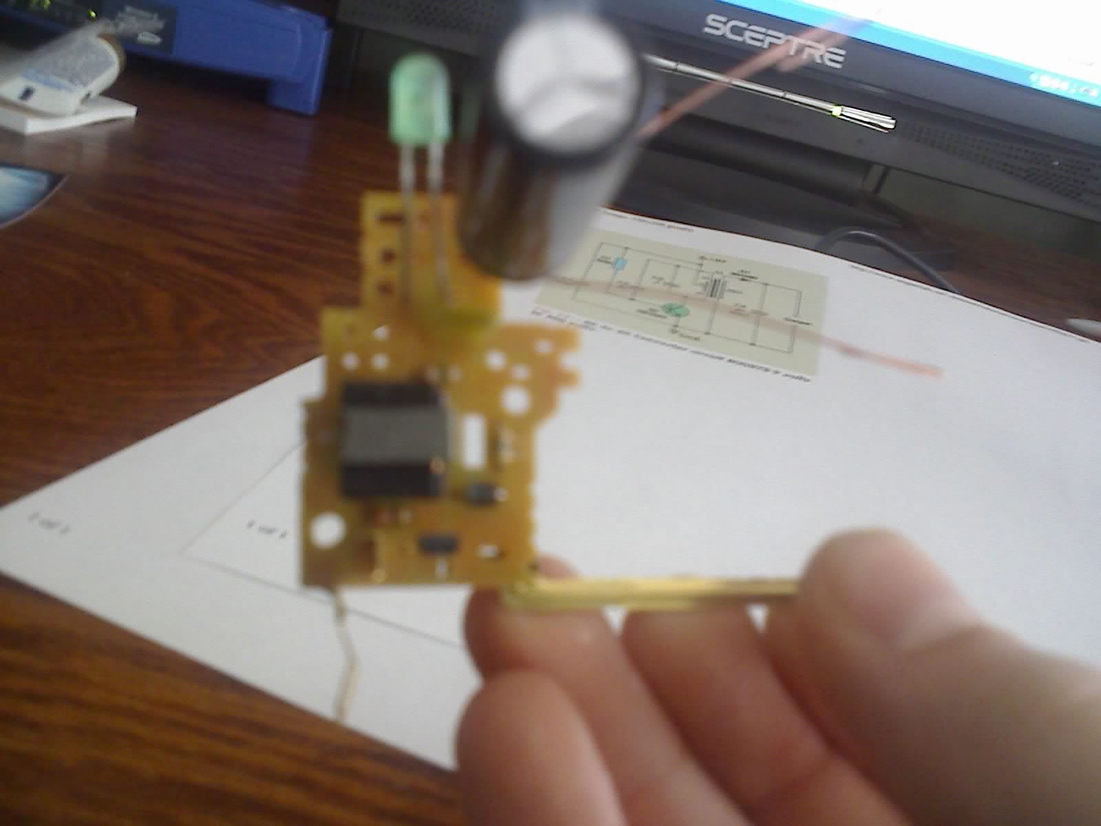

Good News!
I went out and bought a couple disposable cameras and opened them up. After doing some testing, I can get 250V in about 2 seconds across the Camera's Capacitor. I know that If I hook this up as it is now, the Little MOSFET would blow on it. The Part# is D2687. There is also a quick PIC of the modified Circuit (removed the Trigger Coil, Switches, Flash tube and added a few other things). Can I replace the MOSFET with a stronger FET?
EDIT: Picture was upside down :p
Found the Datasheet:
It is a low frequency amplifier? What can I replace that with?
Select a Mosfet with a voltage rating higher that you have and a current rating high enough for your load.
Ok, thanks I will have to look around then.
Well it is going to be working in short circuit mode (aka coil)
What channel should I pick? N-Channel?
What MOSFET should I pick? I was going to order some parts later today.
