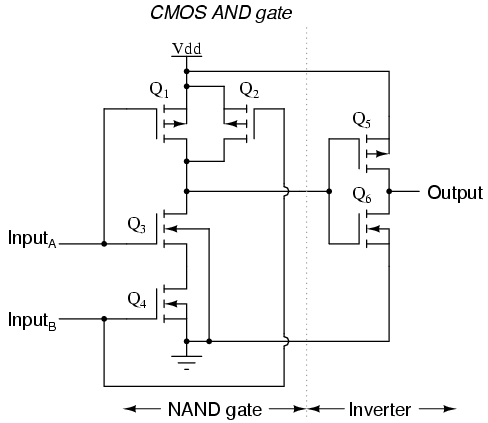

AND gate cmos transistor sizing
AND gate with cmos transistor
we can create cmos AND gate with 3 nmos and 3 pmos transistor
Equation X=AB
AND gate cmos circuit= <-NAND--Inverter->
I want to size the transistor so that the output resistance is same as that of inverter with nmos W/L=3/2 and pmos W/L=6/2
parallel pmos (L will double with same W)
pmos 1 W/L=6/4 and pmos 2 W/L = 6/4
nmos series ( W will double with same L)
nmos 1 W/L= 3/4 and nmos 2 W/L=3/4
transistor size for AND gate cmos
nmos 1 W/L=6/4
nmos 2 W/L=6/4
nmos 3 W/L=3/2
pmos 1 W/L=3/4
pmos 2 W/L=3/4
pmos 3 W/L=3/2
IS this correct sizing for AND gate
look at this Image
how to do transistor sizing for this Image
1)can we keep same size ?
2) when we size transistor what should we know?

This must be school work. Most of us are not still in school trying to design an IC that is 46 years old, instead we simply buy them and use them in circuits that we design.
The old CD4081 has 2 more stages of inverters that your circuit does not have and it also has a protection circuit on each input that is missing on yours.

ok I will do myself but I have some doubt
1)why the ratio W/L is important in cmos circuit
2)why nmos and pmos transistor at inverter have different W/L ratio (nmos W/L=3/2, pmos W/L=6/2)
You should ask an engineer who designed these old ICs, ask your teacher, look in your text book or look in Google.
