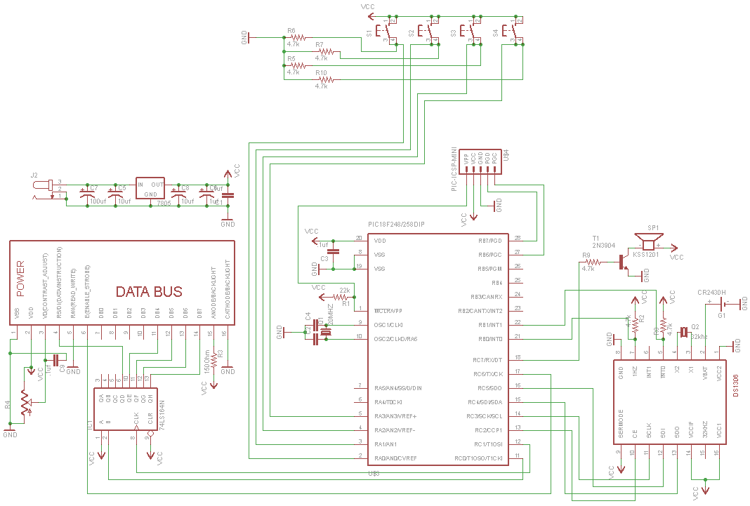

3v0: I am not switching over without solving a issue. The entire clock works fine. Now that it does i am trying something new. This something new is just the same thing but instead of reading buttons using the "165" im doing it with PORTA and instead of reading time all the time :) im redaing it using the 1hz interrupt.
I will still use the DS1306 as a clock since it does reduce the actual work of me having to make the entire thing and it as that battery backup which i can place a battery, no issue.
This is INDEED just a clock. But the thing is i do plan to mix it into another project in future. (security system) and even if i did it on a pic i can make the pic accept SPI commands as a slave and basically make my own type of DS1306 with my own code hence i dont have to do any BCD at all.
But for now i plan to ues this DS1306 since i got it :D
here is new my REV 2 schematic. I made the schematic first so i can follow it better when writing code.
I must have missed that part :) You have a tendency to rush from one project to another. At some point soon you need to take the time to get it right. Upgrade you coding skills. I am amazed at how fast you have progressed. Take this as a pointer or concern on my part, not a negative comment.
3v0
i will surely take it as a pointer although i will also address it as a concern. I will work on sticking to 1 thing for long enough to ensure i understand it to the point where i dont get lost as much. I will also try to up my coding skills as to minimize size and time. I always take anything said whether good or bad about me as something good. If i did something bad that means i am trying at least if i did something good it means i tried and succeeded.Thanks again. I will stay on this clock for at least 3-5 more days until i feel that its something i think i and/or someone would like/buy.
Even tho its not for sale its nice to imagine if someone else likes it its a good job done :D
Here is my button setup now. Using RA4:RA1 now.

#define alarmOut  LATBbits.LATB3
#define alarmOutT TRISBbits.TRISB3
#define alarmIn   TRISBbits.TRISB4
Variables
char string[] =  "                ";
char string2[] = "                ";
unsigned char lDate[16];
unsigned char myTmp;
/*       NEW VARs       */
unsigned char decHour;
unsigned char decMin;
unsigned char decAPM;
unsigned char decDate;
unsigned char decMonth;
unsigned char decYear;
unsigned char time[16];
unsigned char comDate[16];
unsigned char view;
Main
void main(void) {
    ADCON1 = 0x0E;
    initSPI();
	lcd_init();
    SDL_T = 1;
    Button_T = 0xFF;    //TRISA (all input)
    RTCRegWrite(0x8F,0x05);
    UpdateTime();
    view = 0;
    while(1) {
        myTmp = Button;
        if(myTmp == selectBtn){
            if(view == 1){
                sprintf(string,"  AtomSoftTech  ",0);
	            lcd_string(string);
                view = 0;
            } else {
	            lcd_string(comDate);
                view = 1;
            UpdateTime();
            while(myTmp == selectBtn){myTmp = Button};
RTC Tools
Convert Char(byte) to BCD
unsigned char uint2bcd(unsigned char ival)
	return ((ival / 10) << 4) | (ival % 10);
Convert BCD to Char(byte)
unsigned char bcd2dec(unsigned char aBCD, char type)
    char lowNyb = aBCD & 0x0F;
    char highNyb = aBCD >> 4;
    char MyDec = lowNyb;
    char x;
    switch(type){
        case 0:
            highNyb &= 0x0F;
            break;
        case 1:
            highNyb &= 0x01;
            break;
        case 2:
            highNyb &= 0x03;
            break;
        case 3:
            highNyb &= 0x07;
            break;
        case 4:
            highNyb &= 0x00;
            break;
    for(x=0;x<highNyb;x++){
        MyDec += 10;
    return MyDec;
Read a Register off the DS1306
char RTCRegRead(char adx){
    char tmp;
    CS = 1;
        WriteSPI(adx); //sec
        tmp = ReadSPI();
    CS = 0;
    return tmp;
Write to a Register on the DS1306
void RTCRegWrite(char adx, char data){
    CS = 1;
        WriteSPI((adx | 0x80 ));
        WriteSPI(data);
    CS = 0;
Initialize SPI
void initSPI(void){
    CS_T = 0;       //CS is output
    SCL_T = 0;      //SCL is output
    SDA_T = 1;      //SDA is input
    SDO_T = 0;      //SDO is output
    OpenSPI(SPI_FOSC_4,MODE_10,SMPEND);
    CS = 1;
        WriteSPI(0x8F);
        WriteSPI(0x00);
    CS = 0;
LCD Functions
Send String to LCD
void lcd_string(char *senpoint){
    delay_ms(1);
	while(*senpoint != '\0'){
		lcd_char(*senpoint);
		senpoint++;
Send Data(Nybble) to LCD
void lcdByte(unsigned char dNyb,unsigned char rs){
	int i;
	LCD_DAT=0;							//Clear 74LS164 set initial bit to 0
	for(i=0;i<8;i++){				    //repeat for 8 bits
		LCD_CLK=1;LCD_CLK=0;			//write 0's to the 164
	for(i=0;i<4;i++){				    //output the nybble
		if((dNyb & 0x08) != 0)
			LCD_DAT=1;
		else
			LCD_DAT=0;
		dNyb=dNyb<<1;
	LCD_DAT = rs;						    //output the RS bit value
	LCD_DAT = 0;
	e_togg();
Toggle E Line
void e_togg(void){
	LCD_E=1;LCD_E=0;
Set LCD Line
void lcd_line(char line){
    if(line == 0x01)
        lcd_cmd(0x80);
    else
	    lcd_cmd(0xc0);
LCD Send Command
void lcd_cmd(unsigned char letter){
	unsigned char temp;
	temp=letter;
	temp=temp>>4;
	lcdByte(temp,0);
	temp=letter;
	temp=temp&0x0f;
	lcdByte(temp,0);
LCD Send Character
void lcd_char(unsigned char letter){
	unsigned char temp;
	temp=letter;
	temp=temp>>4;
	lcdByte(temp,1);
	temp=letter;
	temp=temp&0x0f;
	lcdByte(temp,1);
LCD Initialization
void lcd_init(void){
    LCD_E_T = 0;
    LCD_CLK_T = 0;
    LCD_DAT_T = 0;
	lcdByte(0x03,0);
	delay_ms(5);
	e_togg();
	delay_us(160);
	e_togg();
	delay_us(160);
	lcdByte(0x02,0);
	delay_us(160);
	lcd_cmd(0x28);					//set 4-bit mode and 2 lines
	delay_us(160);
	lcd_cmd(0x10);					//cursor move & shift left
	delay_us(160);
	lcd_cmd(0x06);					//entry mode = increment
	delay_us(160);
	lcd_cmd(0x0d);					//display on - cursor blink on
	delay_us(160);
	lcd_cmd(0x01);					//clear display
	delay_ms(500);
Delays (S,mS,uS) for 20Mhz
    Delay Second(s)
void delay_s(int S){
    int y;
    char x;
    for(y=0;y<S;y++)
        for(x=0;x<4;x++)
            delay_ms(250);
    Delay MilliSecond(s)
void delay_ms(int mS){
    int y;
    for(y=0;y<mS;y++)
        Delay1KTCYx(5);
    Delay MicroSeconds
Lowercase 'u' is common
symbol for Micro
void delay_us(int uS){
    int y;
    char x;
    for(y=0;y<uS;y++)
        for(x=0;x<5;x++)
            Nop();
readBtn
char readBtn(void){
    return Button;
LCD / RTC stuff
void UpdateTime(void) {
    unsigned char tmp,tmp2;
    char i;
    // Fill In the LCD String
    time[0] = 'T';
    time[1] = 'i';
    time[2] = 'm';
    time[3] = 'e';
    time[4] = ':';
    time[5] = ' ';
    time[8] = ':';
    time[11] = ' ';
    time[13] = 'M';
    time[14] = ' ';
    time[15] = ' ';
    // Get Date
    comDate[0] = 'D';
    comDate[1] = 'a';
    comDate[2] = 't';
    comDate[3] = 'e';
    comDate[4] = ':';
    comDate[5] = ' ';
    comDate[8] = '/';
    comDate[11] = '/';
    comDate[14] = ' ';
    comDate[15] = ' ';
   // Get Minutes
    tmp = RTCRegRead(0x01);
    time[10] = (tmp & 0x0F) + 0x30;
    time[9] = (tmp >> 4) + 0x30;
    // Get Hours
    tmp = RTCRegRead(0x02);
    time[7] = (tmp & 0x0F) + 0x30;
    time[6] = ((tmp >> 4) & 0x01 ) + 0x30;
    // GET AM or PM (already read register 0x02)
    time[12] = ((tmp >> 4) & 0x01 ) + 0x30;
    if(time[12] == 0){
        time[12]='A';
    } else {
        time[12]='P';
    //Get Month
    tmp = RTCRegRead(0x05);
    comDate[6] = (tmp >> 4) + 0x30 ;
    comDate[7] = (tmp & 0x0F) + 0x30 ;
    //Get Date(day)
    tmp = RTCRegRead(0x04);
    comDate[9] = (tmp >> 4) + 0x30 ;
    comDate[10] = (tmp & 0x0F) + 0x30 ;
    //Get Year
    tmp = RTCRegRead(0x06);
    comDate[12] = (tmp >> 4) + 0x30 ;
    comDate[13] = (tmp & 0x0F) + 0x30 ;
	lcd_line(2);
	lcd_string(time);
	lcd_line(1);
    if(view == 0){
	    lcd_string(string);
    } else {
    decMonth = bcd2dec(RTCRegRead(0x05), 2);
    decDate  = bcd2dec(RTCRegRead(0x04), 0);
    decYear  = bcd2dec(RTCRegRead(0x06), 0);
    decHour  = bcd2dec(RTCRegRead(0x02),1);
    decMin   = bcd2dec(RTCRegRead(0x01),3);
    decAPM   = bcd2dec(RTCRegRead(0x05),0);
    decAPM   = (decAPM >> 4) & 0x01;

Hey Jason,
I hope you don't think I was criticizing your code. I just wanted to give you another perspective. If anything, your progress this last year makes me think you're some kind of a savant or prodigy (grin).
Take care.
Mike
Thanks alot you guys are making me feel proud. Ill try to keep up the good work. Im sorry i havent been on in a while. 2 days ago at night i caught a tooth infection(too many sweets) and i had the tooth pulled yesterday and also caught a fever yesterday and felt like i was dieing. Today i feel a little better. Still have small pain in tooth. I dont want to eat since it hurts so i guess i gotta take it slow today as to not drain myself.
Ill be working on the clock today for sure since there isnt alot to do. Mainly just set date/time/alarm which since ive done it a few times already it doesnt seem to hard.
