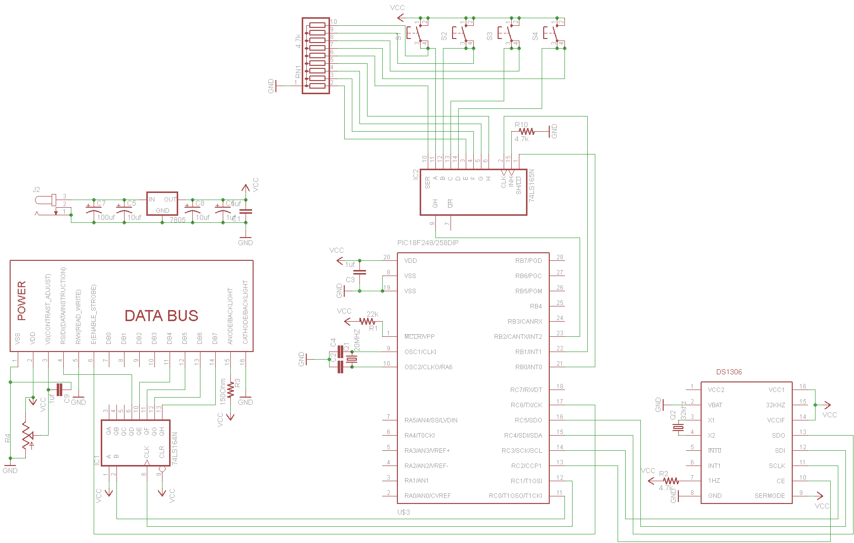

hey some of you know i have been working on a clock using a DS1306 and i wanted to post this for anyone who wants to see it. at the moment you can only set the time. Its a huge file.
You can study about BCD conversions, SPI, Shift Registers(74LS165 & 74LS164). I say you can study mainly because it all works so far. And if it works then maybe it can help some people.
Im in the process of adding code to Set the Date including Day, month, year, actual day... take a look.
I rewrote my old code. This should be a nice read for some.
#include <p18F248.h>
#include <stdio.h>
#include <delays.h>
#include <spi.h>
#pragma config WDT = OFF, LVP = OFF, OSC = HS
Prototypes
void initSPI(void);
void e_togg(void);
void lcd_line(char line);
void lcd_cmd(unsigned char letter);
void lcd_char(unsigned char letter);
void lcd_string(char *senpoint);
void lcd_init(void);
void delay_ms(int mS);
void delay_us(int uS);
void delay_s(int S);
void lcdByte(unsigned char dNyb,unsigned char rs);
char RTCRegRead(char adx);
void RTCRegWrite(char adx, char data);
void showMenu(void);
void setDate(void);
void setTime(char type);
static unsigned char uint2bcd(unsigned char ival);
char readBtn(void);

I though i should post a schematic... i just made it so it may have errors lol. I have to double check it.
Ok finally done with code or well not 100% but like 95% i just need to mess with a buzzer for the alarm and have the enter/select button silence the alarm. I have not tested the alarm. I assume i can use the INT straight off the chip to drive a transistor in which will drive my buzzer.
I never had to use a PNP transistor gonna re-read some info on them since the INT0 goes low when active. Hence i need a pullup on it.
