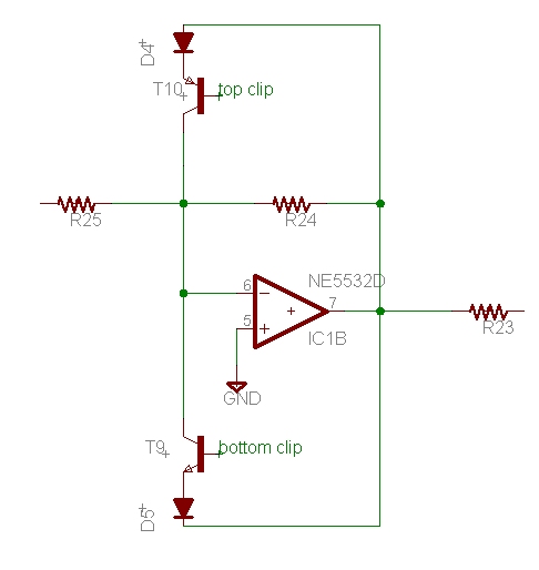

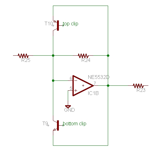

Here is a method of controlling the output voltage swing of an op-amp. If the output is too high the top transistor turns on. If the output is too low the bottom transistor turns on.
I am working on an audio amplifier with controlled clipping.
Set the “top clip” and “bottom clip” voltage to correct values.
If the clipped output has less than 5 volts swing do not use the diodes.
If the clipped output is more than 5 volts swing add the diodes.
where do I apply these voltages? to the bases of the transistors?
dazz000

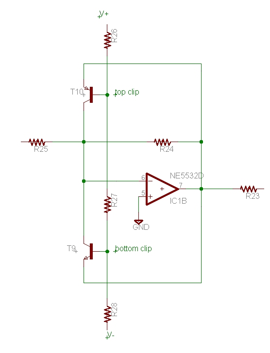

I just posted a third picture where the base voltages are set by a resistor divider.
In my case I set the base voltages to +5 and –5.
In your case you want the most positive swing to be 5 volts so set the top base at 4.3 volts.
