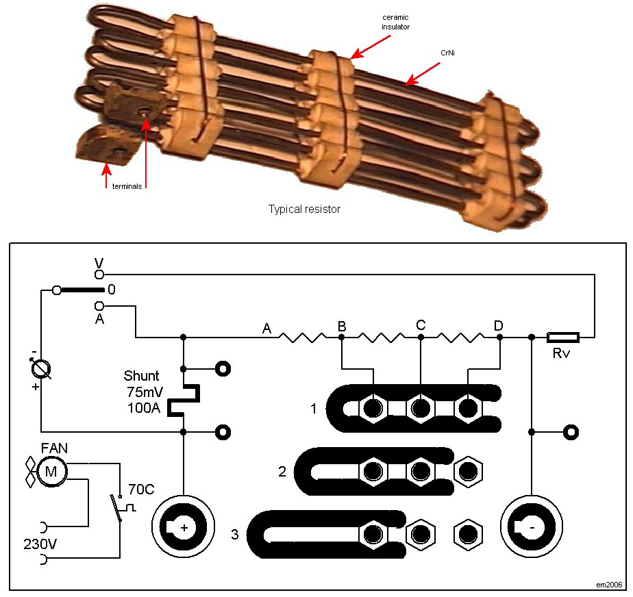

This is my solution - a home-made device.
(load.jpg)
Thanks em2006, I understand the schematic, what is the resistor or carbon rods made from? (appliance or etc????)
The resistor from the picture (load.jpg) is made by me.
I made various resistors using a resistance wire from 2 to 5 mm diameter,
to test welding inverters wich I repare (need load from 5 to 250 Amp).
I use resistance heating wire, Nickel-Chromium Alloy, 80% Nickel/ 20% Chromium.
If you can't find desired wire diameter, you can use more paralelled small diameter wires.
You also can use a small coller to avoid overheating if undersized wires are used.
About material, you can find some informatiobs here:
https://www.electro-tech-online.com/custompdfs/2006/11/NI80.pdf
http://www.leybold-didactic.com/phk/themen.asp?B=PhKE&PT=4.5&L=2
