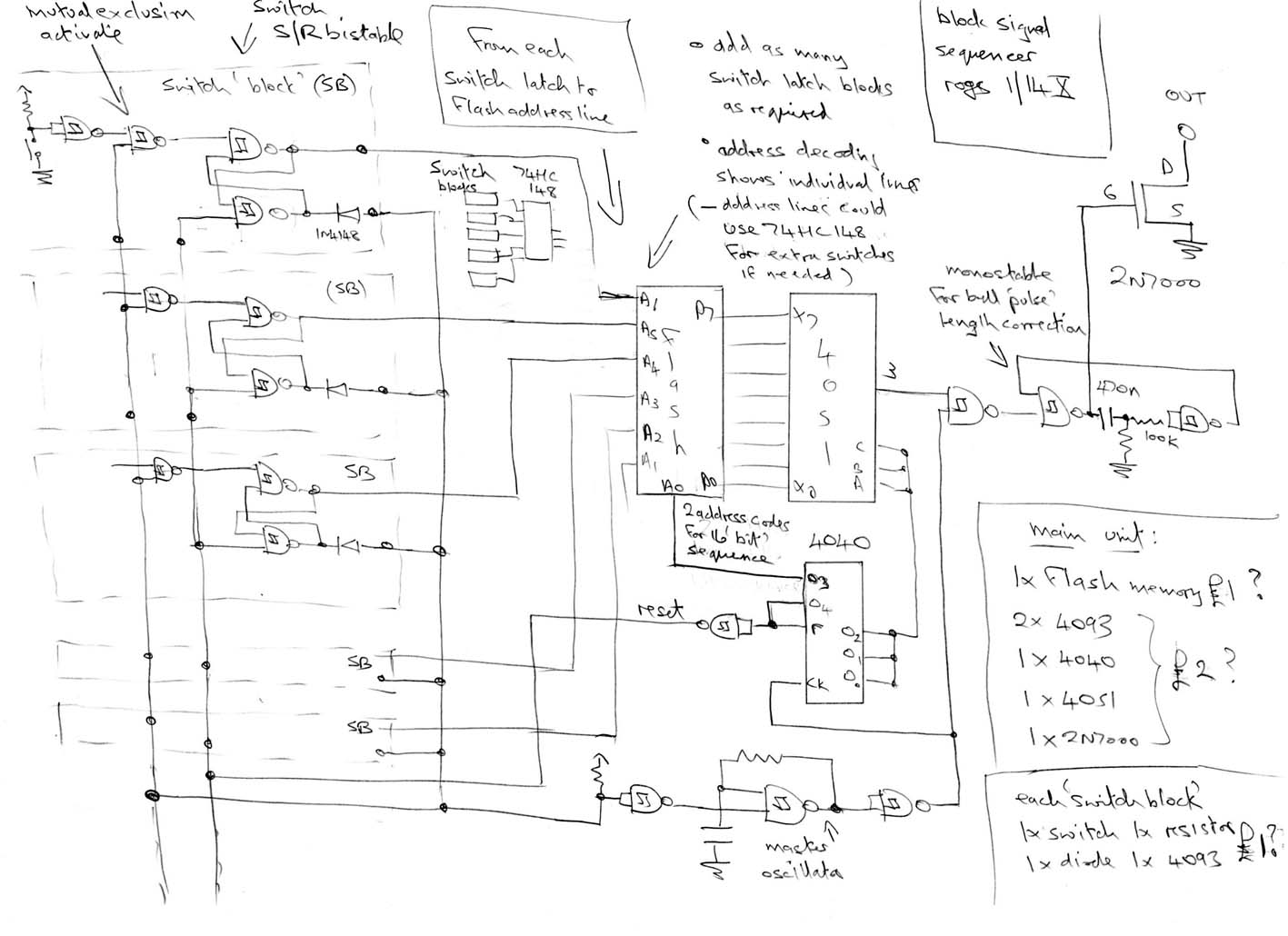

Anyway, here's a sketch of my hardware idea : blockbell.jpg
It's not very pretty I'm afraid -- but it's only to illustrate the sort of circuitry that would be involved ......

Anyway, here's a sketch of my hardware idea :View attachment 83246
Yes that's the idea if we had to do this in hardware. I had a similar idea in mind, using counters and decoders. One counter and one 1 of 8 decoder and we get 8 output steps. But i guess he isnt afraid of microcontrollers so he seems to like that route best.

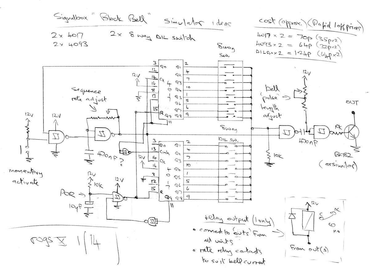

Although the microcontroller route is clearly a favourite option, especially for those who already have some experience ( and equipment!) with their chosen uC, from what I read the hardware 'set up' costs for a one off project (like this one) are still quite high.
The last two posts from dr pepper and KISS made me think again.......a more modern version of the EPROM and counter suggestion by dr pepper might be to use flash memory. Assuming one can find a cheap way to program one flash chip (you could buy a cheap programmer for about $35, and sell it on ebay afterwards :) ) then using that flash chip, and a few logic chips could get you a cheap unit that could easily replay thousands of 'sequences' (if necessary) for less than the cost of setting up for your uC project. And no code to write - just a few flash addresses to program.
The pages that KISS linked to show how simple (but robust) the original equipment was......doing it in hardware is sort of in keeping with that original concept :)...
Think I'll sketch it out........

I've done a very rough concept sketch (attached) and I reckon it's probably the cheapest and simplest way of doing this. Simply by adding individual switch block 'latches' as required (1 x momentary switch, 1 x resistor and 1 x 4093 on a bit of stripboard -total cost about £1), and possibly an extra couple of 74HC148 ICs to increasing the address decoding options, if needed, and you can have as many individual 'sequences' programmed into the flash memory as you need (up to the size of flash --say 512 thousand? :))
Got to be the easiest option - or at least the cheapest! The most awkward bit would be making sure you convert your binary sequence address requirements into Hex, to program into the flash!

Sounds like you sussed it.
I think you could do without the analogue mux, however it would make programming a lot longer, probably not so good if your doing it with switches.
That circuit will probably be handy for other uses too.
Get a bag of leds for the address and data or you'll get well confused.
Also make sure the flash you use is capable of running down to static speed, flash chips usually do but make sure.
I did a similar circuit back in the early 90's, it was a baudot tty beacon, and a mate of mine did a similar thing that transmitted a rs232 preamble and the temperature from a thermocouple, they used I think a 2716 eprom, you had to erase them with ultra violet.

KISS -- I can see the kind of information you are going to need, to be able to deal with the detail of the hardware needed as 'glue' for your uC solution.... and then the need to consider embedded programming - I2C - matrix keyboard - assymetric current source/ sink port options --etc -etc..
I'm beginning to be even more convinced now that a simple hardware approach is probably a better solution for this 'one off' project.
-Simple 4000 (or 74HC) series logic chips.
-An open drain output to drive a single relay - (so that the bell drive option only needs to be defined by the current capability of external relay contacts)
-An open structure for infinite (momentary) input switch additions.
-A single flash chip, to contain as many sequences as required.
There are clearly cases where uCs are really the only sensible option for a project - especially where lots of units are to be built. I'm not sure any more that this is one of those projects?.....It seems as if the extra hardware needed to be added on is almost as much as the complete project in hardware, without any uC?
Maybe the OP is beginning to wish his original post hadn't asked for 'suggestions' :) ?...
