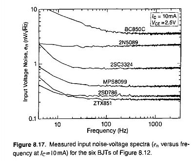

However, most really high quality microphones or small signal preamps use discrete transistor preamps rather than opamps, at least in the first stages.
That's either a FET such as a 2SK107, 2SK118 or, oddly enough, a small high current transistor such as a ZTX851; they appear to have exceptional low noise characteristics.
