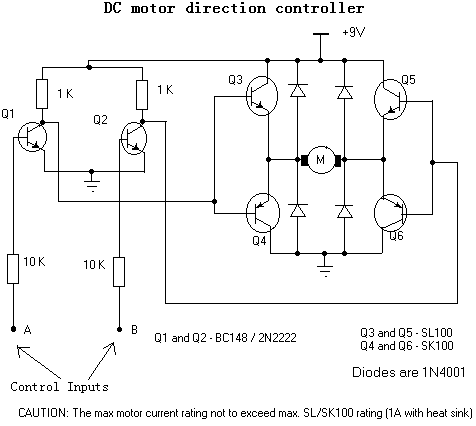

hey can any1 help me understand this circuit by explaining it please.thak you in advance:)
A high on input a, low on input b q1 conducts lowering voltage on it's collector which in turn causes q4 to conduct, meanwhile since there is a low on input b the collector of q2 is at a high level which causes q5 to conduct this gives a path from ground thru q5, the motor, and q4 to +9v. operation is mirrored using q3 & q6 if swap input levels. If both inputs are high then only the pnp transistors are biased for operation and no complete path for current to flow, if both inputs are low then only the npn transsitors are biased for operation and thus no complete path for current to flow.
Short circuit - yes
It should work fine as long as all maximum ratings are not exceeded.
Yea right. Vbe ≈ 0.6V aprox. And Vbe on both transistors is coupled in series. That means any supply voltage above ≈1.2V will short through emitter-base on each couple of transistors.
Yeah, that schematic must be drawn wrong or something.
Swapping the SL100's with the SK100's might work, but i'd test it first.
Operating Q1 and Q2 in cutoff/saturation prevents shorting through. A pair of high-value resistors connected between the bases would ensure the current from the drivers at the tie point is sufficient to prevent short through. Better to replace the drive transistors ( Q1 & Q2 ) with IC invertors to reduce drive impeadance. Significant current would flow during transient, so that period must be short and low duty-cycle. If not the case, then an alternative layout is requried.
PS, never allow the inputs to the bridge to "float"

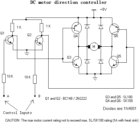

Corrected h-bridge
NOtice what MrAl wrote. If you swap the upper and lower transistor, it might work - or it progably will (if control circuit works). The circuit you posted here will sort of act like two set of two diodes in series in forward direction and therefore it will short.
Adding resistors between the bases of a pair of complementary transistors (Q3 - Q4) will not solve the problem. The transistors will connduct all the time (draw lot of current, but not shorting).
I draw a corrected version of the h-bridge that should work.

Yes, where as Grossel's version runs the transistors in a linear mode, losing loads of voltage for the motors, and overheating the transistors.
You really do need to feed the motors from the collectors, and not the emitters.
We don't know how much power the motors will dissipate, so the transistors doesn't have to burn.
